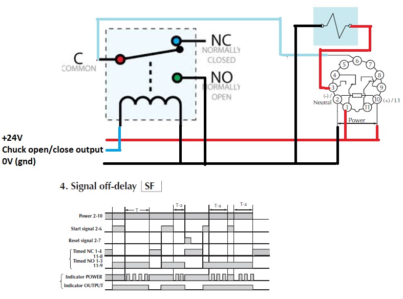

Strantor,
As long as you aren't fed up yet, could you please continue to work with me.
Sorry I've had the flu. Now that I've slept 40 out of the last 48 hours I can't sleep anymore.
Les et al,
I get what you are saying about pins 2 and 6 now. The timer is looking for a dry contact closure to start the timer. Right?
right
right
Therefore, I should connect timer pin 2(neutral from the robot PS to C and timer pin 6 to NO. NC on the relay should be left blank.
right
On the contact side of the timer, jumper pin 1 to pin 2. Pin 3 should be wired to the common side of the solenoid. The hot side of the solenoid would be wired in parallel with pin 10(24V from the PS.) Thoughts?
Sure, I drew it (below) the other way around but either way works.
Hi Joe, Terminal 2 on the timer to C on the small relay (The contacts only need to carry a few milliamps.)
Agreed. Although I drew it the other way around, doesn't really matter if you think of it as a SPST switch.
Terminal 6 on the timer to NC on the small relay. (NOT normally open)
I disagree
Disagree. The timer starts upon LOSS of the "START" signal (chuck OPEN signal).
Disagree. Two lefts doesn't make a right in this case. If we follow the timing diagram, we are looking for a LOSS of the "start" signal (chuck OPEN signal), followed by a timed period of no state change, followed by a LOSS of output (chuck CLOSE). The conditions which reflect this are in the timed N.O. line. We see that at the end of the timed period, the NC contact CLOSES.
Here's how I drew it up. "start signal" means "chuck open signal." That's true coming out of the robot controller and coming out of the intermediate relay
"gate signal" and "reset signal" are not needed
I apparently think backwards from everybody else because I drew everything on the opposite sides of the contacts, but as has already been addressed, it doesn't really matter.
Oh yeah, and you should put a freewheeling diode in there as well to protect the relay from inductive spikes.
1N4004 is what I normally use.

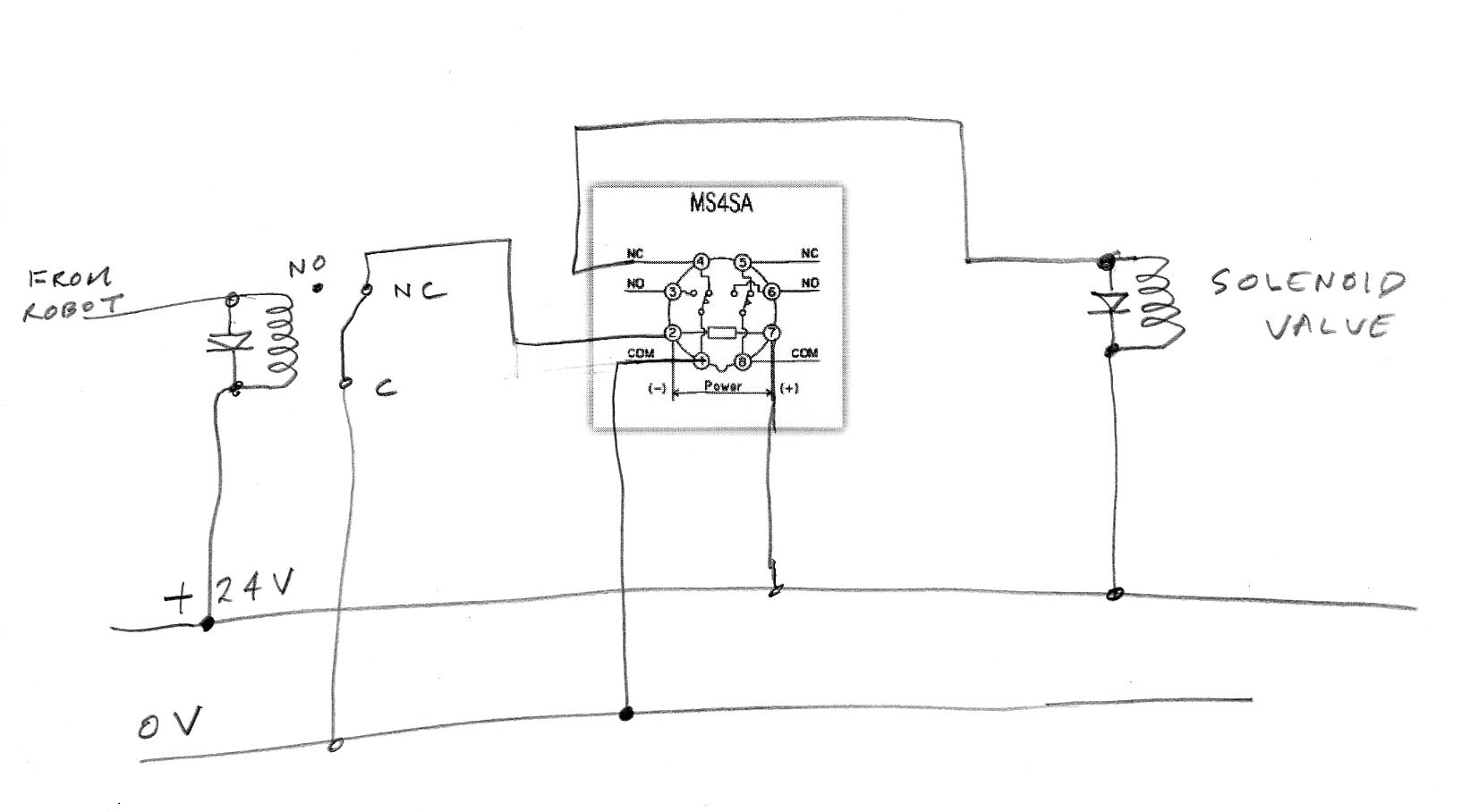

Hi strantor,
My comments were for use with the delay-on timing diagram. I agree that your method will work with the signal off delay diagram. I think the original MS4SA timer could be used connected like this.
Les.
Hi strantor,
My comments were for use with the delay-on timing diagram. I agree that your method will work with the signal off delay diagram. I think the original MS4SA timer could be used connected like this.Les.
Oh, ok gotcha. I didn't expect that since you said this:
I am assuming we are talking about the MS4SM that strantor suggested using.
But now that we're on the same page, I must tip my hat. Your solution is much better considering he already has the ON-delay timer in-hand.
The logic is a bit hard to wrap my head around...

Hi Joe,
Can you draw the schematic of EXACTLY how the solenoid valve was wired originally. Is the 24 volts DC supply totaly switched off when the chuck is closed. I had the impression that the positive side was connected directly to one end of the solenoid valve coil and the other end of the coil connected to the negative via a "contact". The "contact" could be a relay contact, a bipolar transistor or a mosfet.
Les.

Hi Joe,
You need to find the negative connection of the 24 volts supply. It is this that you need to connect to the 0 V connection on my diagram. The diagram you have posted only shows the output terminal strip /connector. The negative of the 24 volt supply will be connected to the other side of the contact that originally fed the solenoid valve. (The "contact" may be a relay contact, a transistor or a mosfet.)
Les.
Reading your circuit, this is what I come up with.
1.) In normal condition (chucks open) there will be 24V from the robot control circuit applied to the coil which will pull the relay to NO.
2.) I should wire up a constant 24V direct from the PS to both pin 7 of the timer and the + side of the solenoid.
3.) When robot calls for (chuck close) the 24V from the control circuit will be removed from the coil allowing the 0V side to continue to pin 2 on the timer.
4.) Because there is a constant 24V on pin 7 of the timer once the relay opens it completes the circuit powering up the timer.
5.) Once time expires, timer contact closes which passes 0V from PS to negative side of solenoid
6.) Resetting happens when chuck open signal is called for because it reapplies 24V from the control circuit to the coil which removes the 0V from pin 2 on the timer (breaking the timers power circuit.)
So, the plan is to remove the negative (Gnd) lead of the solenoid from its current position on the PLC and reattach it to Pin 4 of the delay timer, correct?
That, actually, ought to work. I had not considered that particular change .
There might be a very slight "blip"of solenoid movement during the transition from No power - Power - No power as the various relays shift (x milliseconds). Chuck grip pressure would, hopefully, be unaffected.
