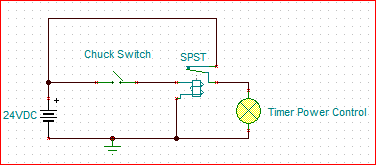

Joe, this may be redundant (I don't have MS Office or Works) but...
This is just a first thought circuit. It's just for control of power to your timer if Electrical Power (EP) is lost:
EP "ON"
EP "OFF"
Am I on the right track, thus far?

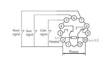

Looking at the Multi-Timer that you suggested it appears I need to do the following:
1.) Apply constant 24V power to pins 2 and 10 (I will pull this off of the robot power supply because the PS is plenty large enough)
2.) Apply a start signal across pin2 and pin 6 (In my mind applying a start signal requires applying 24V to pin 6, but because of the way the robot is programmed applying the chuck close signal drops the voltage to "0". This is where I'm stuck. That as well as the reset signal, and if it is needed.)

Hi Joe,
In statement 2 in post #15 you seem to be planning on applying 24 volts between pin 2 and pin 6. The documentation on the timer only shows closing a contact between pin 2 and pin 6. There is nothing to say that pin 6 is 24 volts positive of pin 2 when the contacts are open. I do not think it is safe to apply 24 volts to pin 6 as the signal could be some lower voltage. I think you would need a small relay whose coil is connected to the chuck close signal and connect a set of normally closed contacts on this relay between terminals 2 and 6 on the timer. When power is removed from the coil the relay contacts would close starting the timer.
Is my understanding correct that if the Chuck OPEN button is pressed before the end of the time delay then you want the chuck to CLOSE strait away ?

I get what you are saying about pins 2 and 6 now. The timer is looking for a dry contact closure to start the timer. Right?
On the Timer, Pin 2 and Pin 10 are coming straight from the robot PS to provide constant power to the timer unit.
As far as the relay, because of the way the robot manufacture designed the circuit, normal operation (Chuck Open) outputs 24V. The coil will be energized connecting C to NO during normal operation. When Chuck Closed is activated, the coil will de-energize connecting C to NC. Right? Therefore, I should connect timer pin 2(neutral from the robot PS to C and timer pin 6 to NO. NC on the relay should be left blank. On the contact side of the timer, jumper pin 1 to pin 2. Pin 3 should be wired to the common side of the solenoid. The hot side of the solenoid would be wired in parallel with pin 10(24V from the PS.) Thoughts?
That's the problem. The trigger for that device needs to be a positive going pulse, not a dry contact.
Joe, the circuit I posted is for providing the 24VDC when the "Chuck Open" button is pushed. This 24VDC could then be used to power up a "on energisation type One Shot Timer", such as this:**broken link removed**, in this configuration:
(snip taken from its the data sheet: https://media.digikey.com/pdf/Data Sheets/Crouzet PDFs/88827zzz.pdf, page 2.
Of course, you'd have to construct the circuit I posted, but I believe this arrangement would work for you.
