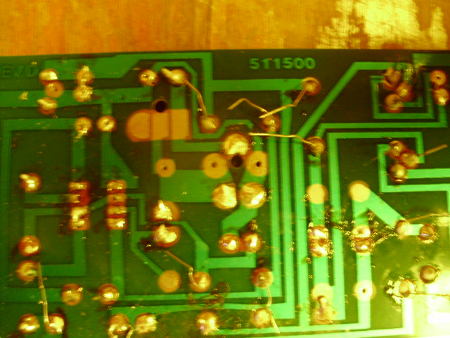

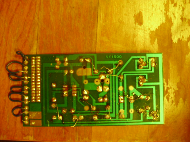

I finished my kit! It looks horrid, I'm not even going to bother cleaning the flux, but whatever. There's a few joints that look pretty good though! When I was going through the desoldering practice to replace resistors to make it work right, it stopped working. I think I might have gotten the 555 timer too hot or something, because it says the desoldering wick gets hot, so I need to hold it with pliers, and I can't figure out what else could be wrong. But whatever I don't care it's probably just because it's cheap. A lot of the joints looked good at first but after they cooled they looked grey. Is that because the iron was too hot?
Take a pic.
Remember what I said earlier, push the soldering iron against the lead, and make sure the lead and pad get hot. With practice, you will know about how long the iron has to contact the connection. Apply solder OPPOSITE the iron. i.e. where the pad and lead meet, but not the iron.
Holding the brad with pliers should not be necessary. Just real out a longer amount. Put braid down over solder and let the braid wick it up. Cut off and discard as the end collects solder.
A good solder joint looks shiny, not grey.
If the soldering iron is too hot then the flux in the solder burns and leaves behind a sticky mess of charcoal.
At the proper soldering temperature the flux evaporates or leaves behind a very thin light colored film on the outside of the solder joint.

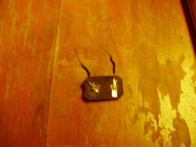

I took apart a 9 volt battery and soldered some wires to the connector end to attach 9 volt batteries to, and no matter what I did, colder, hotter, held the iron on it longer, shorter, whatever, it always turned grey a few seconds after I took the soldering iron away. It always looks nice and shiny at first, but I guess as it cools off and solidifies it does that.
Lead free solder hardens and looks frosted upon hardening, not shiny as when melted.
You can't solder to some metals easily. That contact may be plated with a metal that is difficult to solder too. This also might be where a specific flux is required. See: https://en.wikipedia.org/wiki/Flux_(metallurgy)

A pic! Finally!
I couldn't get much better pictures than this with my camera.
9 volt connector:
