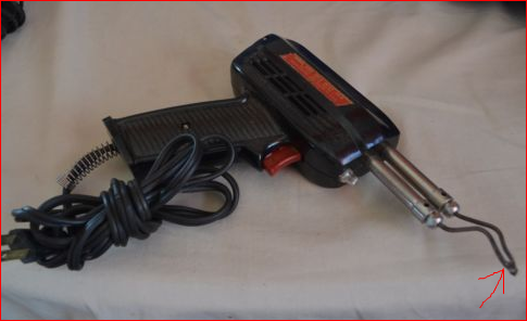

Started with an old Weller "gun" type in the late '50s (I think it was 100/140 watts ...!).
The bent up tip is exactly how mine always looked :woot: (kept having to straighten it with a pair of needle nose). Used Kester .125 rosin core solder.
The tips (solid copper) came un-tinned and I always tinned them up first thing. Never worried much about cleaning the tip: just shook off excess since I was doing tube type, boat anchor circuits (Allied Radio Knight kit sort of stuff).
But the excess rosin (slightly acidic) would collect (where I stuck the arrow above) and, without fail, that's where the copper would corrode and break. Went through beaucoup tips before I made that connection (no pun intended...). I'd just tension the two halves against each other and keep on solderin'.

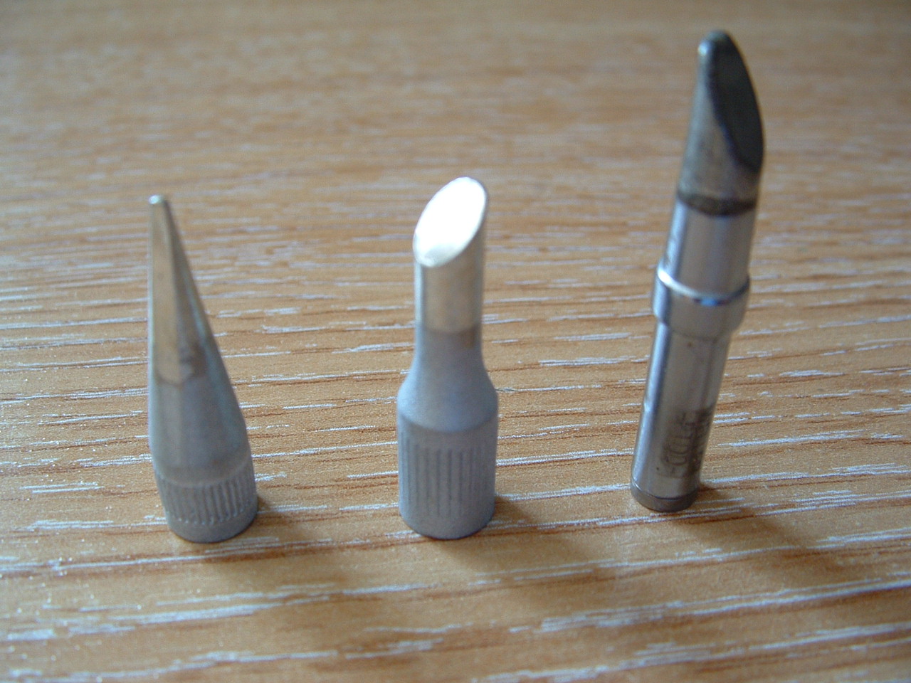

Look at this picture:
Two Oryx tips left and centre and a Weller tip on the right.
The Oryx tips have certainly never been used, and I don't think that I have ever used this Weller tip.
The tips are made from copper and have an iron coating, the Oryx tips are slightly magnetic. I did not bother to test the Weller tip as it has a magnet in it anyway, that is how the temperature control works.
The iron coating is a dull grey colour on the Oryx tips and there is a bright coating at the end of the tip where it was dipped in solder at the factory when it was made.
When using a tip for the first time, I would always melt plenty of solder on to the tip as soon as it got hot enough.
When wiping a tip on a sponge, there is no way that the solder layer is going to be removed completely, it will just stay there a few microns thick.
Some of the very "high end" soldering procedures from organisations such as NASA, say to put a small amount of solder on the tip before putting the iron into its stand. This may offer some advantage with regard to a cleaner tip before the next joint is made, but I suspect that the effect is marginal.
Note that copper is soluble in solder, which is why tips are iron plated.
A bare copper tip will be dissolved away by the solder which it melts. There is a type of solder known as "SaveBit" which contains a small percentage of copper in the nominal 60/40 tin/lead mixture.
It must be nearly 40 years since I last used SaveBit, but it was effective and reduced the wear on the old plain copper soldering tips.
