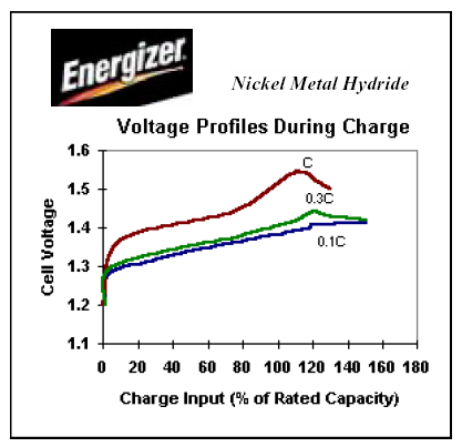

A Ni-MH cell is 1.2V halfway in a discharge but it is 1.4V to 1.5V when fully charged. You cannot even use 4 cells.
Since you do not have a charger circuit then your idea of blasting 1A of current into the unknown size of the cells would probably destroy them. The charger circuit must detect the full charge (not the voltage, but the temperature rise or voltage drop when fully charged) then turn off the overcharging or switch to a very low trickle charge.
Here is from the Energizer battery company Ni-MH manual:

But I overlooked the fact that 1.2V is not charged. Your graph seems to indicate that the voltage goes from 1.5V fully charged to 1.2V empty; so 5 cells will go from 7.5V (still within the 9V panel charging capacity) to 6V when empty (barely within the AMS1117-5 uselful input voltage).

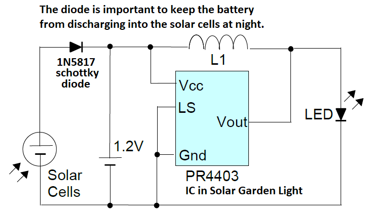

The diode is VERY important to keep the battery from discharging into the solar cells at night. All my solar garden lights have it:
(A)------|>|---|>|---|>|---|>|---|>|---...---|>|---|>|---|>|---|>|---|>|--- (K)
30 diodes X 0.7Vf = 20Vf
(+)----------------------------------13.8V battery-----------------------------(-)
Above is a representation of a 'nominal' 12V solar panel and a fully charged '12V' battery.
Connecting (+) to (A) and (-) to (K) as in above : current will not flow at dark as the battery is less than 20V.
It is the representative case of why the lack of a blocking diode in series with the solar panel does nothing to prevent current flow when dark. Simply the battery voltage does not overcome the panel Vf. The properties of the panel itself do the prevention.
In all cases of having a battery connected directly to solar panel, the sum of 0.5V generation per cell is less than the 0.7Vf per-diode presents, implying the battery will never overcome the panel Vf.
For a garden light:
(A)-----------------------|>|---|>|---|>|---|>|-----------------------------(K)
4 cell solar panel = 2V = 4 diodes x 0.7Vf = 2.8Vf
(+)--------------------------------1.4V charged cell-------------------------(-)
Connecting (+) to (A) and (-) to (K), current will not flow at dark as cell is less than 2.8V
I tested two different solar panels from garden lights. Both produce 2.60V in sunlight with no load and both conduct when dark. They even conduct a little in darkness with the 0.2VDC from my multimeter Ohms test.
That is why all solar garden lights have a diode to prevent the battery from discharging into the solar panel at night.

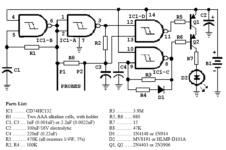

Edit: by the way audioguru, this project is using your fantastic moisture measurement oscillator circuit from several years ago.

The little circuit I borrowed from you (attached) is a genial piece of hardware: robust, very accurate (I get about 0.05% accuracy and repeatability when doing highly precise microcontroller rmeasurements), and fairly easy to tune once the habit is there.

I found the original defective Plant Watering Watcher circuit online and fixed it 13 (!) years ago. I am glad to hear that you still use it and like it.:)
