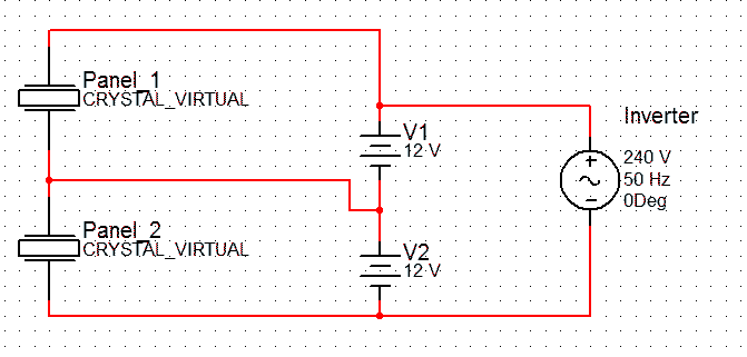

if I put the panels in series and the batteries in series but also had a centre "tap" from the battery junction to the panel junction then they would be each individually charged but i would still be able to get 24 volts back for the inverter

General idea with 2 different car batteries is as attached.
Thunder if you charge them separately you have to discharge them separately. So you'd basically have two separate 12 volt systems.

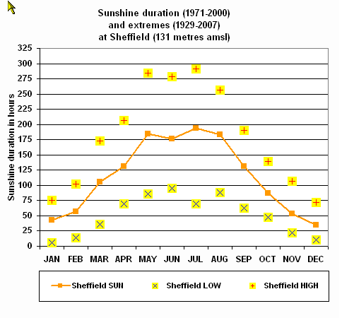

Get the local sunshine hours and intensity for your area and work out how much power you would get from
say a 1mtr square solar panel.
[the solar panel manufacturers data will give the power outputs]

Not been vey lucky also at finding the sunshine hours and intensity in my area.
