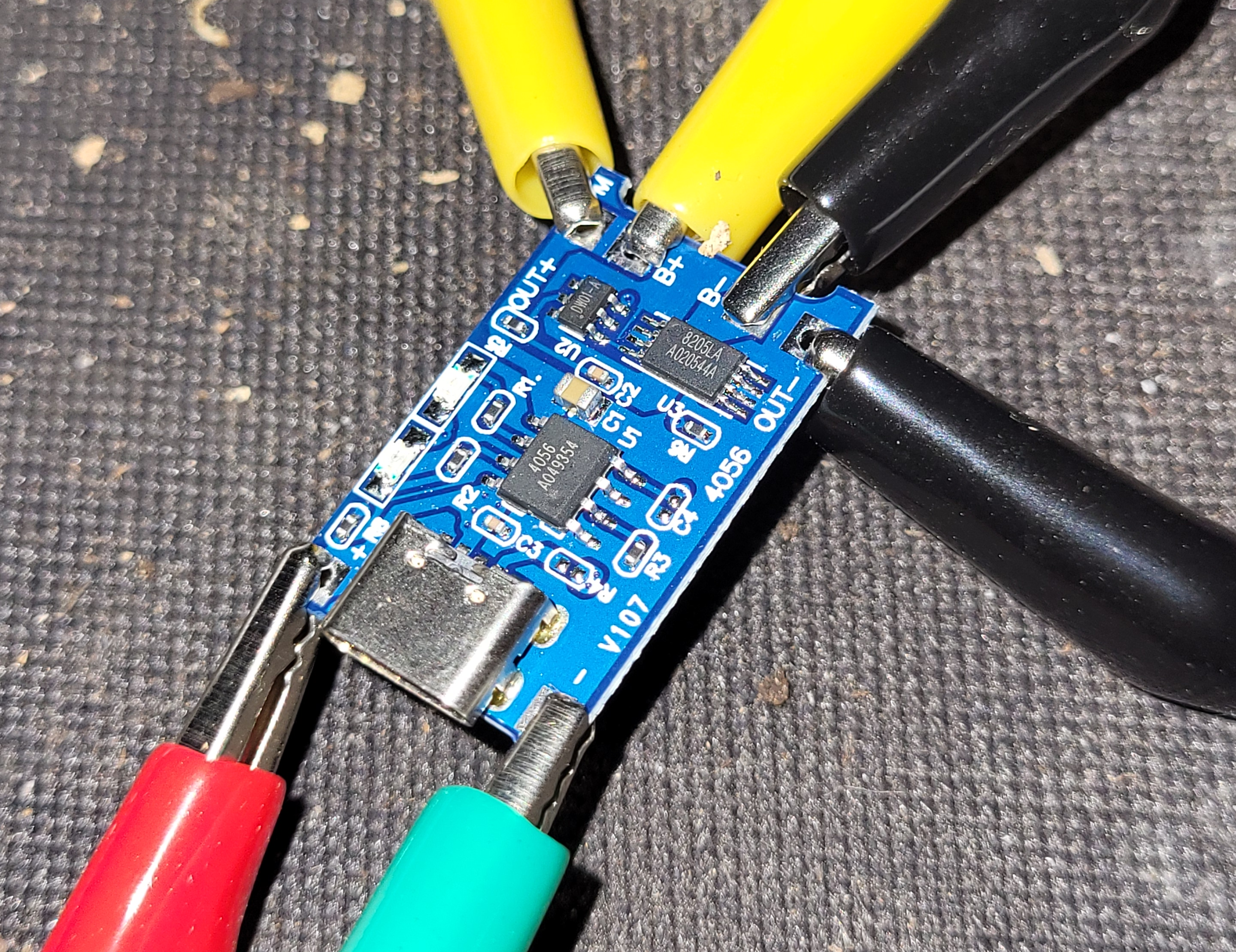

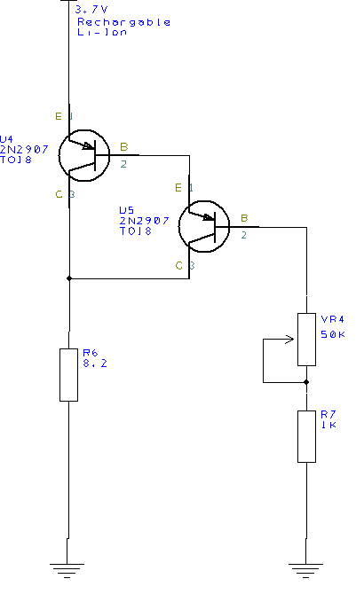

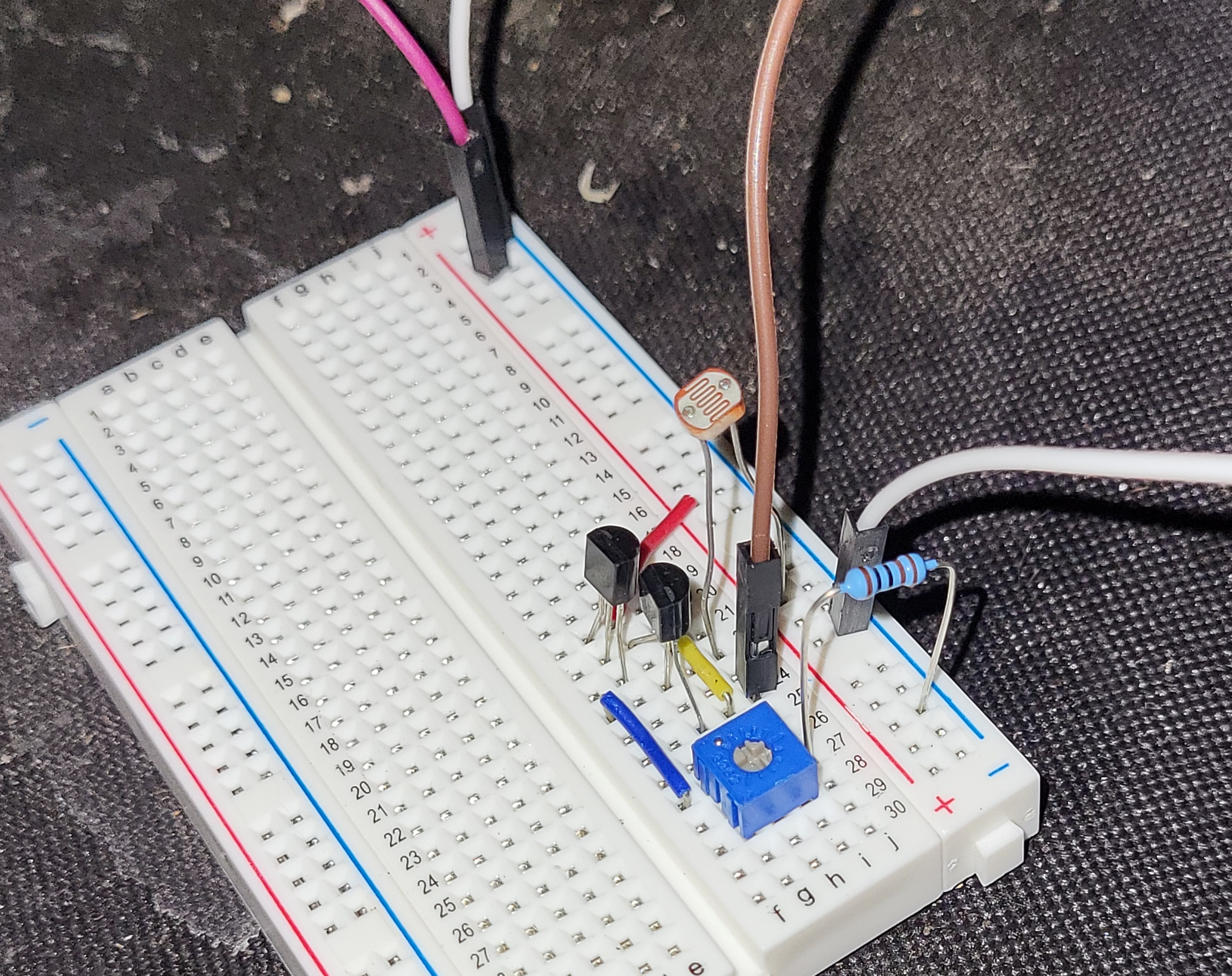

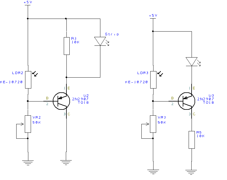

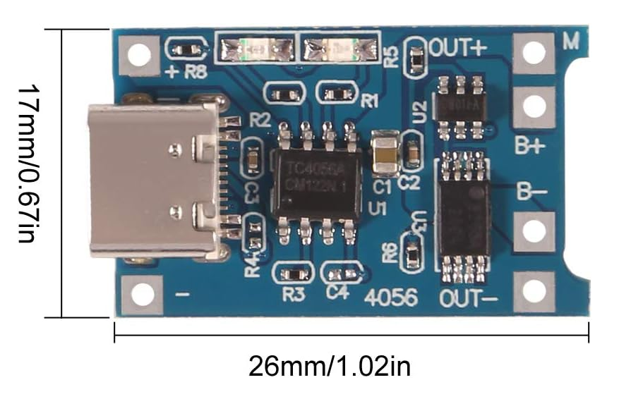

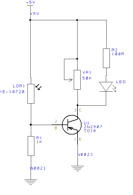

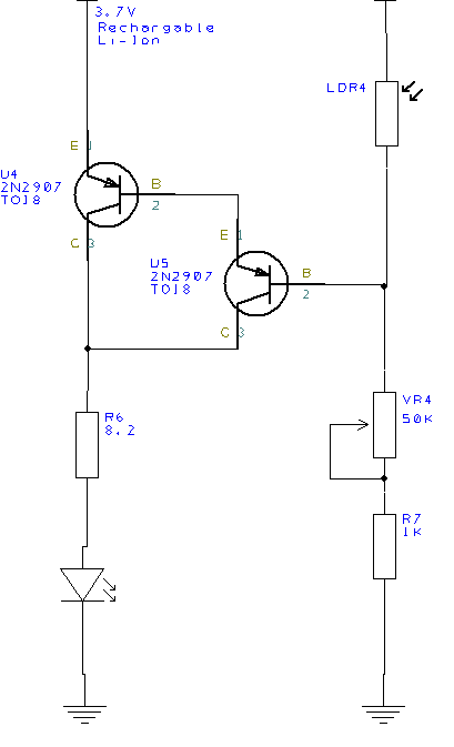

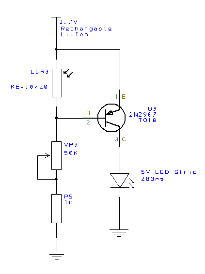

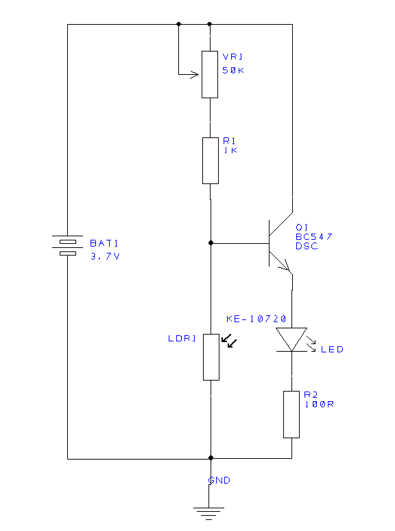

This sample circuit uses an LDR to switch on a single LED with a 547 NPN. Could you assist me in updating this so it will drive a small strip of LED lights. They draw a little less than 300ma. I have some larger transistors and mosfets. The circuit runs off a 3.7v Li-ion battery that is charged from a 5V 3watt solar panel. A "charge controller board" manages the battery and prevents overcharging. When fully charged the output is 4.2 volts. The led strip is 5volt 280ma. The battery alone provides more than enough light despite the voltage but this NPN is not enough to drive more than 100ma.
