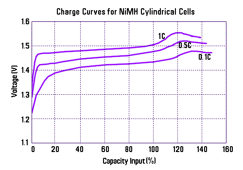

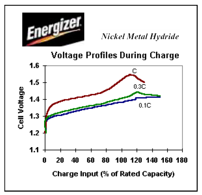

I have an electric RC airplane. Its AAA Ni-MH cells become warm when they are charged to 1.48V each.
Battery manufacturers have graphs for the charging voltage of their Ni-MH cells:

Look again at the charge curves I attached before. A 3.6V Ni-Cad battery is fully charged when its voltage reaches 4.2V to 4.5V.
At only 3.8V the battery has hardly any charge and is almost dead.
