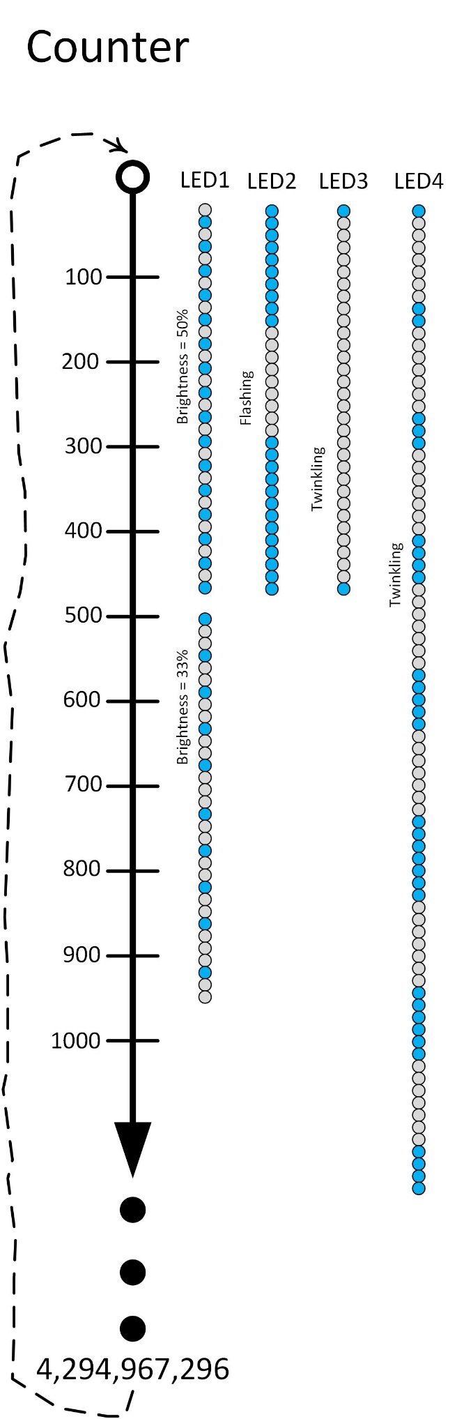

Since MrDEB has been silent today, he may have figured out that a whole bunch of serial routines with delay statements aren't going to accomplish what he wants at least not very well.
One way to do what he wants is to base all actions on a loop counter, with at most exactly ONE delay statement. Ok, let's start with the basic program loop.
Dim Counter as Longword
Counter = 0
While 1 = 1
   // some code will go here
    Inc (Counter)
    If Counter > 4000000000 then
          Counter = 0
    End If
Wend
What happens in this program loop? The variable Counter counts from 0 to 4,000,000,000. This number can actually be 2^32, but rounding it off won't matter much. The IF statement may not be strictly necessary. The Counter value should automatically wrap back to zero.
Pretty neat, huh? Well, let's work on that. Let's add an LED, say at 50% brightness .
Dim LED1On as Longword
Dim LED1Off as Longword
LED1On  = 0
LED1Off = 0
Counter = 0
While 1 = 1
   If Counter = LED1On then
        LED1 = 1
        LED1On = Counter + 20
        LED1Off = Counter + 10
   End If
   If Counter = LED1Off then
       LED1 = 0
   End If
    Inc (Counter)
          Counter = 0
    End If
Wend
Ok, so what happens here? Led1On starts at 0. When the Counter value equals 0, three things happen:

The picture shows the process. On and off periods might be set to random numbers. But remember, all actions are based on Counter values. Exactly one delay statement might be added. MrDEB's fading routine can also be adapted to this technique.

hate to tell you this but it dos not dim. The ratio of on time vers off time stays the same post 108 works very well. Give it a try. Thanks
