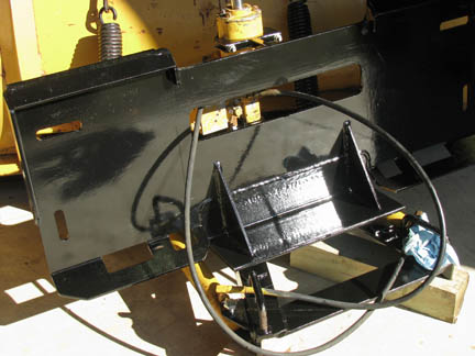

The plow is finished, except for getting some new hydraulic lines made (some of the ends leaked in the old unit) and the electrical. It will be power angling. I had planned to install it today and get some pictures, but I will wait until things dry out a bit from our rains last night.
BTW, I used POR-15/Chassis Saver polyurethane paint on it. It applies a lot differently than the acrylic enamels I am used to. It does dry to a high gloss without brush marks. I am a little worried about its adhesion to the base metal, but maybe that was because it was not completely cured after only 24 hours. Surface was very hard, but since it is moisture curing, I am hoping that is the reason.
John

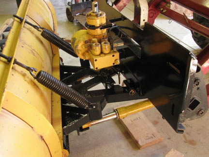

Got it all pinned together and mounted on the tractor today. I was worried about getting the blade attached to the unit by myself (i.e., getting the blade attached with the two pins to the pivot unit). Turns out that was very easy. Just had the blade on its face, put the loader over it, and tilted down.
If it works as I hope, then next year I will shorten the distance that the pump hangs out from the loader mounting plate, which is 5/16 thick. The top bar is about 4"; it could easily be shortened to 1". I only used 2D CAD for this and was worried about clearances to reach the bottom pins on the loader hinge. Basically it is just a Meyer ST7.5 that I shortened the hinge distance from 31" to 16" and put the hinges on the bottom of a skid loader plate. I used 4X6X3/8 angle for that attachment. Based on some rough calculations, I put in gussets to reinforce the rear edge and face plate. Will get the hydraulic lines cut, system flushed, and hopefully have the battery connected to the control solenoid by Friday. Now, all I need is snow to test it (ugh). It was a gorgeous Fall day, as you can see.
