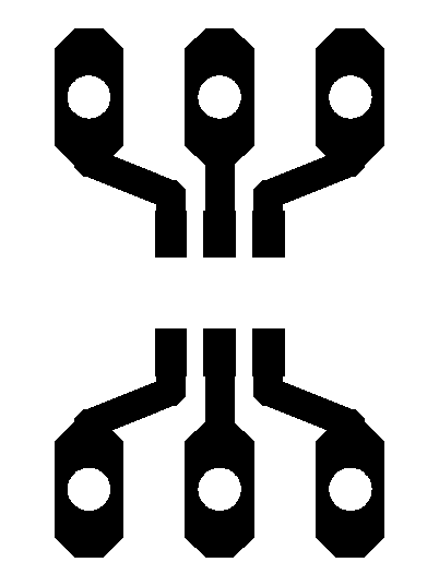

the method is nice but for 6pin SMD's(like max2606) i found it hard.so is there any pre-existing pcb layouts for the SMD IC's,so that we can go with the conventional procedure of laser printing and etching.

but hhhmmmmm my drawing skills always sucks.i tried but unable to get correct layout.if some one tried this before pls share ur experience
you don't have to draw anything ... you're simply taking two pre-drawn layouts and connecting lines from Pin 1 to Pin 1, Pin 6 to Pin 6, etc
if you had an odd package layout, someone might draw it for you, but a 6 pin (sot23-6 I assume) package is as standard as sliced bread.
thanks "just diy"
with ur inspiration i tried and finished with a good one(i think so)
i placed sod23-6,DPI pads and connected them through wires.pls have a look at the picture. **broken link removed**
but one thing bothering me is correct resolution(while exporting as image).when i used 150 it gave me above picture but if i increased it,the image size increased with the quality of pic.so what is the correct resolution for taking printout and etching it.
I export mine at 1200 DPI and then instruct the printer to print at that resolution, so it comes out 1 to 1
export at whatever resolution you're going to print it, typically 300, 600 or 1200 dpi
make sure whatever program you're printing with knows your printer resolution, otherwise a 1200 dpi image will print out HUGE!
