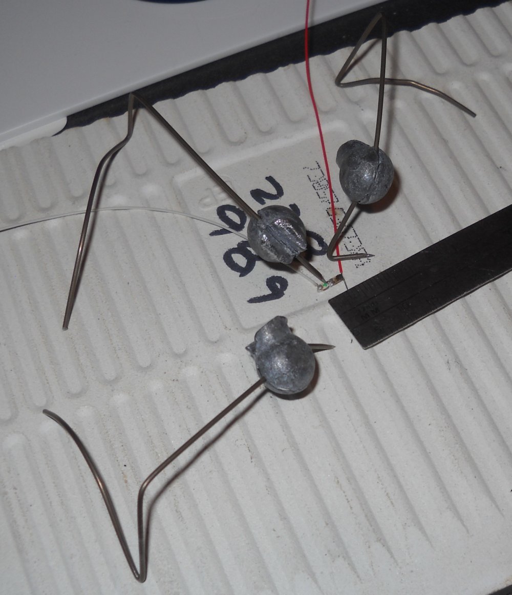

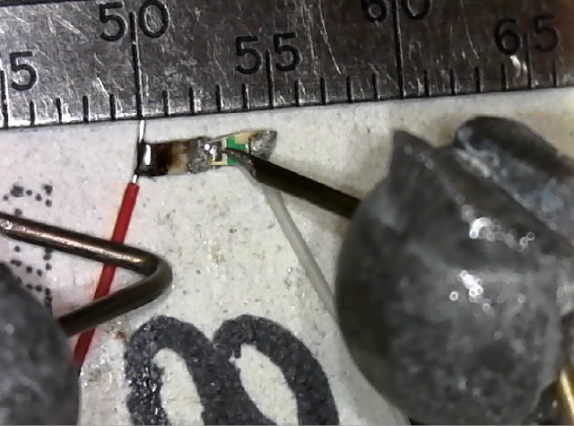

I was having trouble assembling a microscopic SMD resistor, LED and wire wrap wires using dead bug tactics. Then I remembered a third hand tool from welding videos and thought Hmmm.
I made these little tripods from really rigid stainless fishing leader (For catching sharks) with the end ground to a point. I used large split shot fishing sinkers to weigh down the business end. There is room for improvement but they worked great for a first time prototype.

I'm not sure the lead fishing weight is RoHS / REACh registered for sales in Europe - really limits access to opportunity. Other than that, startup money for a fishing weight and a sharpened paper clip should be under $250k.
Ha ha. Thanks guys.
That sinker probably isn't a good idea. The first time you hit it with a hot air reflow tool, it would be a puddle of lead on your PCB.

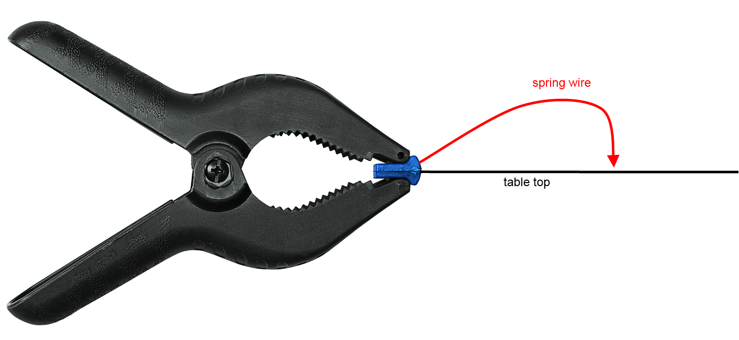

I have a collection of spring clamps like this. Some plastic and some metal. Some are large so they will clamp on the edge of the table. I am going to drill a hole in the end and add a spring wire. Or maybe just put the wire under the clamp. Sorry I don't have a picture of the spring clamp open and clamped on the table edge.
Lead melts at 621°F. Tin in the 400s and solder at 370°F. I think the remote piece of lead will be fine. Even if the hit air is 700°F, it will take quite a while for the lead to reach 621°F.
