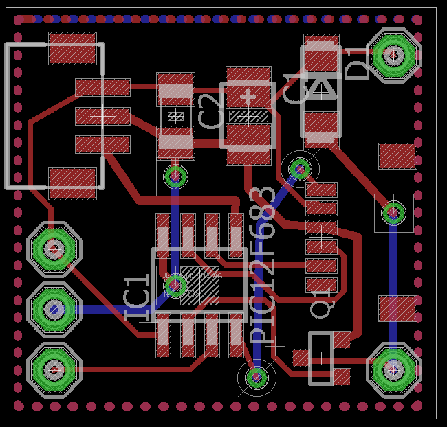

I've decided to do a board completely surface mount in Eagle. The autorouter is pretty useless so I hand routed it. The problem comes when I run a DRC. Eagle reports every connection as a Stop Mask error. Does anyone know a way around this? See board below.
All the white hatched areas are the stop mask. However, I did the library for the 2 JST connectors and I didn't include any stop mask.
Any and all help appreciated.

how are you !! please send me a .brd file and let me also see the drc messages.
and if possible, sch also.
Here's the sch and brd files. Had to rename the sch file to txt.

here i have a link to "stopmask"error and its treatment. please see if this could help you.
Incidentally I was able to open and use the files.
the vss and vdd connection can be removed and the polygons , once named , would take care pummy.
PS: **broken link removed**
this shows another member solving his issue using the suggestion.
in the help , under 'context' i find these comments, Pommie.

Go to the Layer Settings on the top left and turn off the display of those layers. It will only DRC the layers that are visible. You have a lot of layers on for some reason. Just turn on the ones that you are using. Top, bottom, pads, vias, dimensions, silk...
I redid the board with the drc file from DirtyPCB's website and all errors disappeared. Probably because of the Stop layer being off.
