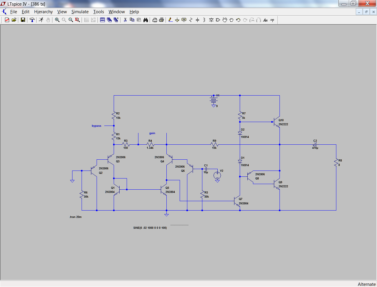

Here is the file for the 386. I'm not sure about the resistor in place of the current source. Maybe audio guru can help.

Thanks Ron! I like to sim then compare with the actual measurements I make, that is the kind of thing that appeals to my OCD :D

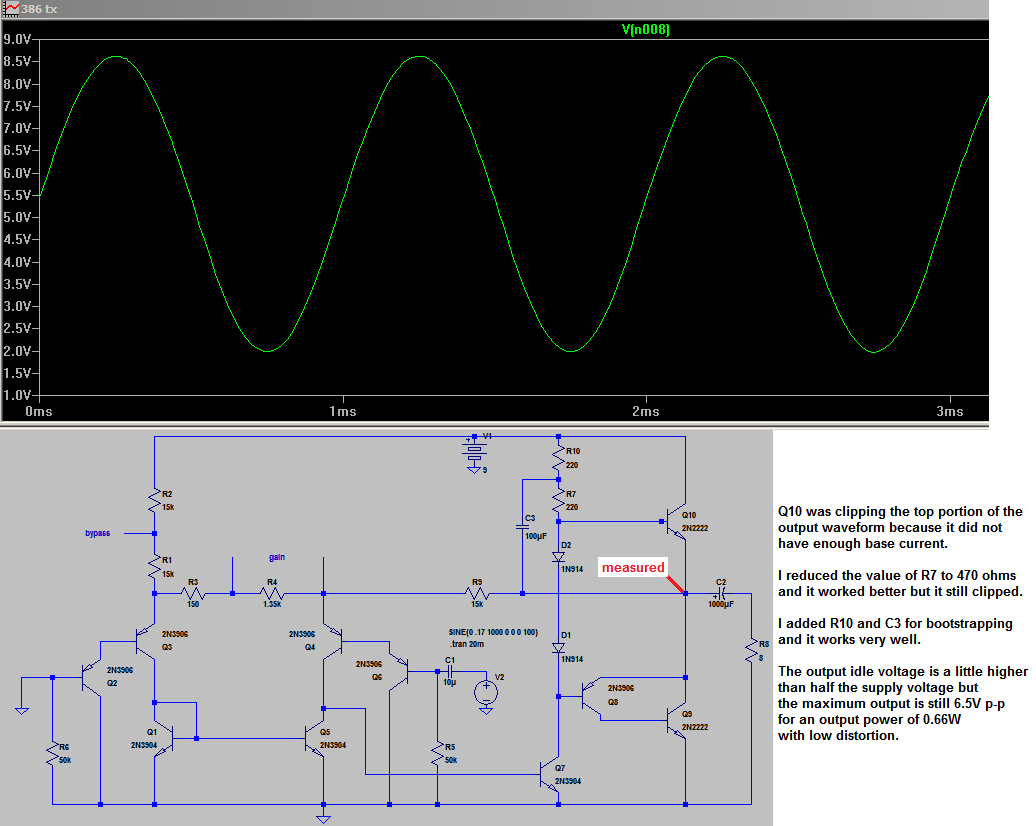

I fixed the sim of the LM386 by increasing the base current of Q10 and booststrapping it.

I didn't and it isn't mine. It was in post #24 by RonV. I simply fixed it a little.

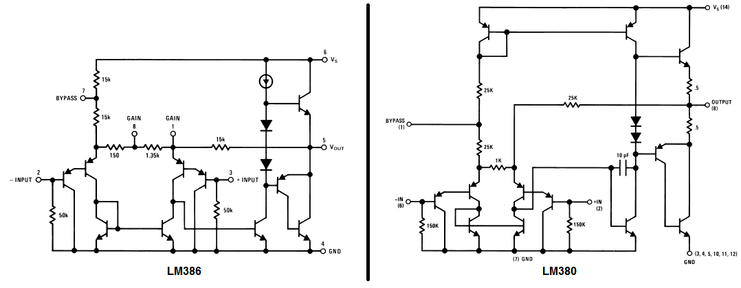

As an LM386 doesn't have a bootstrap capacitor, presumably (as you would expect) it uses a constant current source instead?.
I cheated a little.
The LM380 is almost the same as the LM386 and its datasheet shows its current source:
