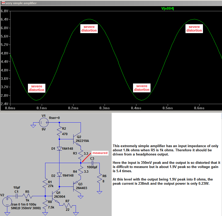

Can anyone point me in the direction of transistor amplifier circuits to drive both 16ohm and 8ohm speakers, the input is from say a laptop (also a MCU with I2S and sound processing), it HAS to be transistor based NO opamps at all and single source supply unless I can build a split source somehow, I need volume mainly but also I need to be able to add filters.

Well, color me lazy. Have a look at the 386 schematic. I think it works as drawn.
https://www.ti.com/lit/ds/symlink/lm386.pdf

You need a minimum of four transistors to make a decent little amp.

I simulated the very simple amplifier with a 9V supply. Its output power is low, its input impedance is also low and its distortion is high.
It will be much better with an added transistor and some bootstrapping.

Thanks AG, any chance I can have the LT file please? I know its taking me forever to get to grips with LT spice but I will crack it one day :D.

Here is my LT sim file and I hope it has everything. The last time I posted an asc file it was missing all the other associated files.
