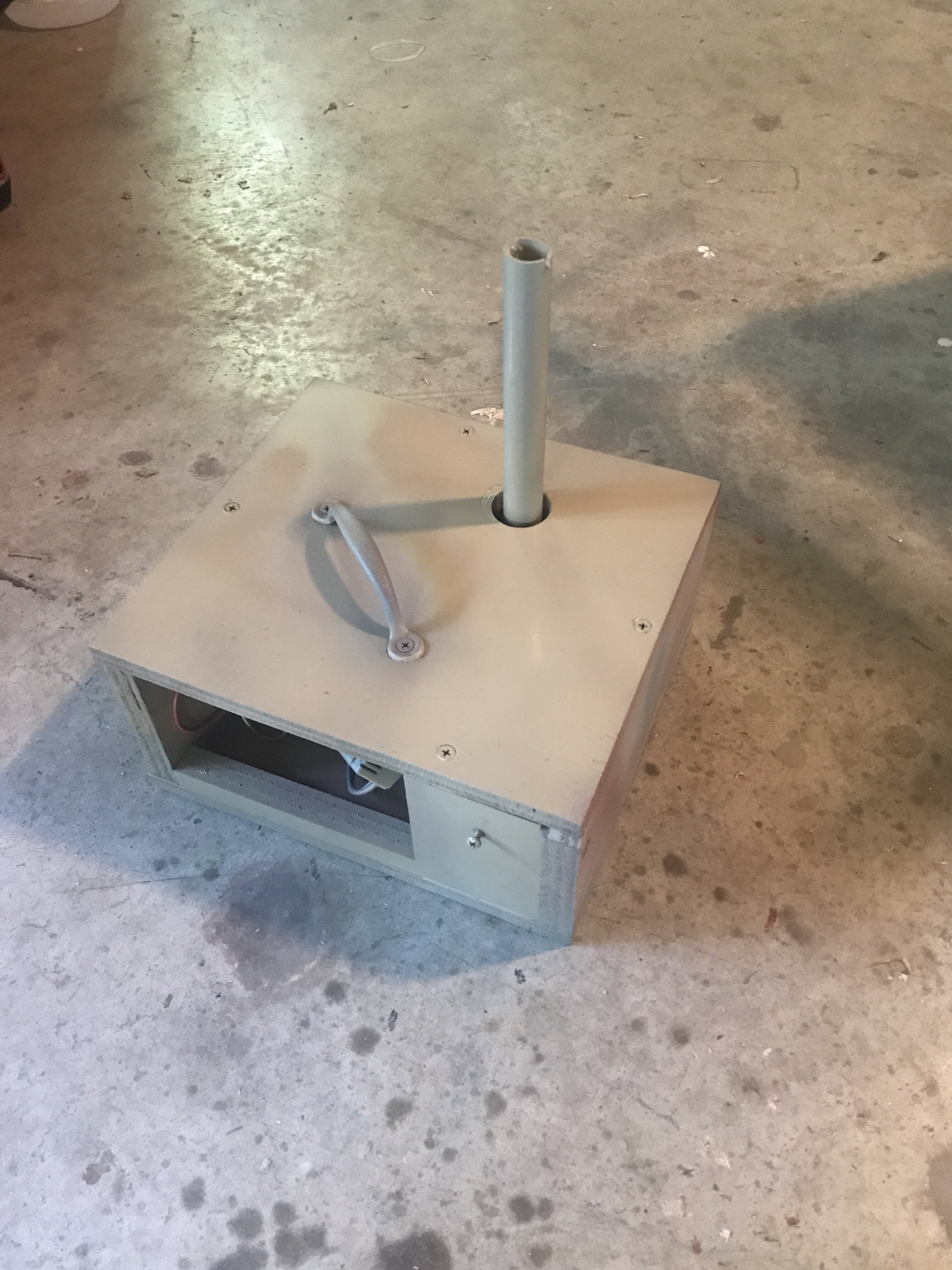

I am using a power window motor to turn a 1 inch diameter 6” pvc shaft onto which can be attached or inserted a variety of light weight objects for multiple purposes, with both forward and reverse direction, powered by a 12v, 7 amp hour battery, with all contents housed in a 10”x10”x5” portable box.
I am attempting to use, with exception of electrical switching/modulating components, items I have on hand. For instance, I have several 7ah 12v batteries I use for bilge pumps, a remote operated farm entrance cable, etc. and charge/swap them as needed.
I am satisfied with my current configuration of motor to shaft, housing, and forward/reverse remote operation, and would now simply like to slow the shaft rotation.

Could you add a second, larger diameter pipe, and have the first drive that with a belt, or something?
That would give you a reduction in speed, but also an increase in torque.
As per #4 , It seems to me that gearing is still the best option, you have the maximum power of the motor, together with extra output torque due to gearing.

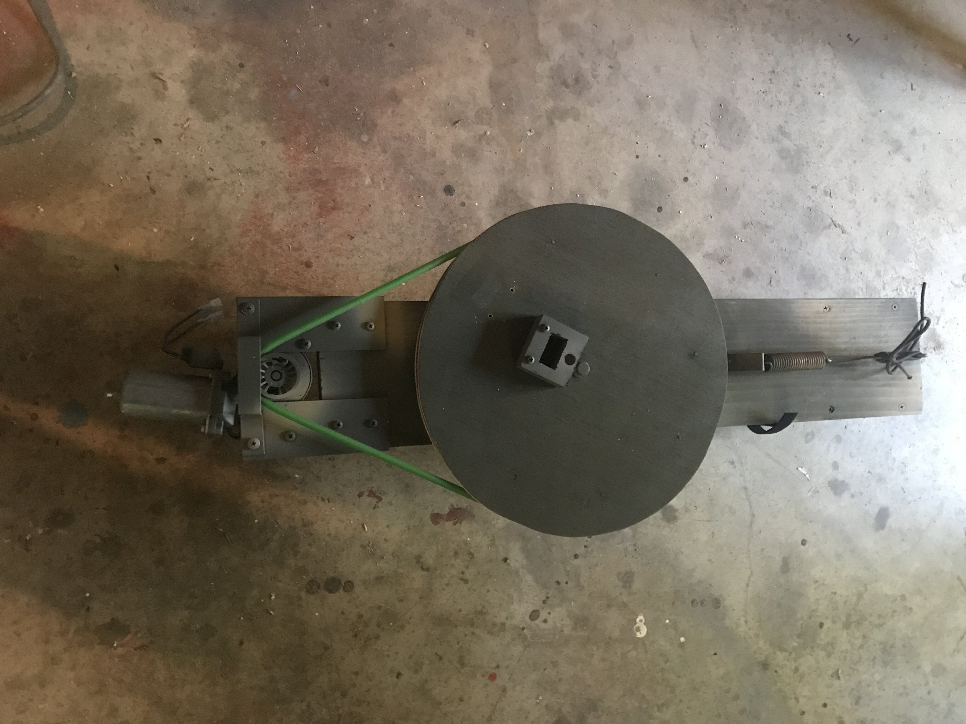

Unfortunately, a major limitation of these motors is that they are designed to turn a male tapered 1” to 1/2” nylon splined cone surrounding a 5/16 steel non-moving support shaft, onto which is inserted a female tapered splined 2” diameter nylon wheel. The combination is trapped by plastic housing in the automotive application, rendering the wheel inaccessible. Here, I’ve used the pvc slip fit over the nylon cone secured with screws to the appropriately 1/4” of available nylon. It wouldn’t be strong enough to tolerate lateral belt tension.
Here’s a version I built with a belt and turntable arrangement for 6:1 speed reduction driving off the 2” motor wheel but the whole thing is way larger than desired and not practical for several desired applications.

Is a PWM not workable due to forward/reverse operation through remote activated receiver module?
It's perfectly workable, just relatively complicated for you. Bear in mind as well that depending on load, the motor current could be considerable, the 3A 'rating' is going to be fairly nominal. You could use a single PWM in the 12V feed to the relays, so it works in either direction.
These motors have an internal circuit breaker. I know from testing, the motors shut down at 10lb dead weight lifting. I wouldn’t approach that in my applications if that helps.
I was concerned the PWM modulation would affect operation of the switching module? I guess not?
What makes the PWM complicated? Is it not just input from source, output to switching module?
If you've got a ready module, then yes.
It won't affect the switching 'module' because the only thing it's feeding is the relay contacts, and from there to the motor.
There are fairly heavy duty PWM modules on ebay for $3.00!
You would need to add the reverse direction feature though.
