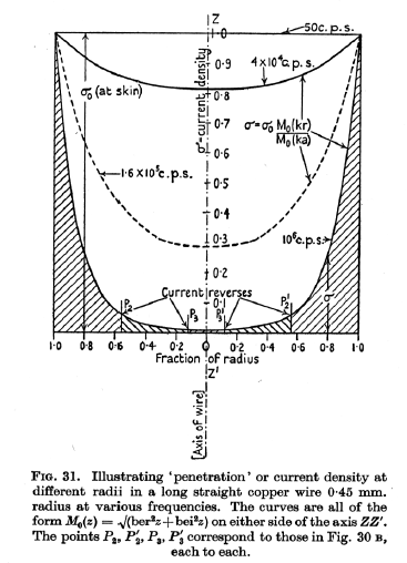

Not in every case, but with certain combinations of frequency and conductor size, the current in the centre can indeed be in the opposite direction.
Edited to add diagram from N.W. McLachlan "Bessel Functions for Engineers" page 156. Note where it indicates the point where current reverses. As you can see, it's possible for it to change direction more than once.
Your diagram demonstrates the decaying waveform traveling into the conductor and the resulting currents.
