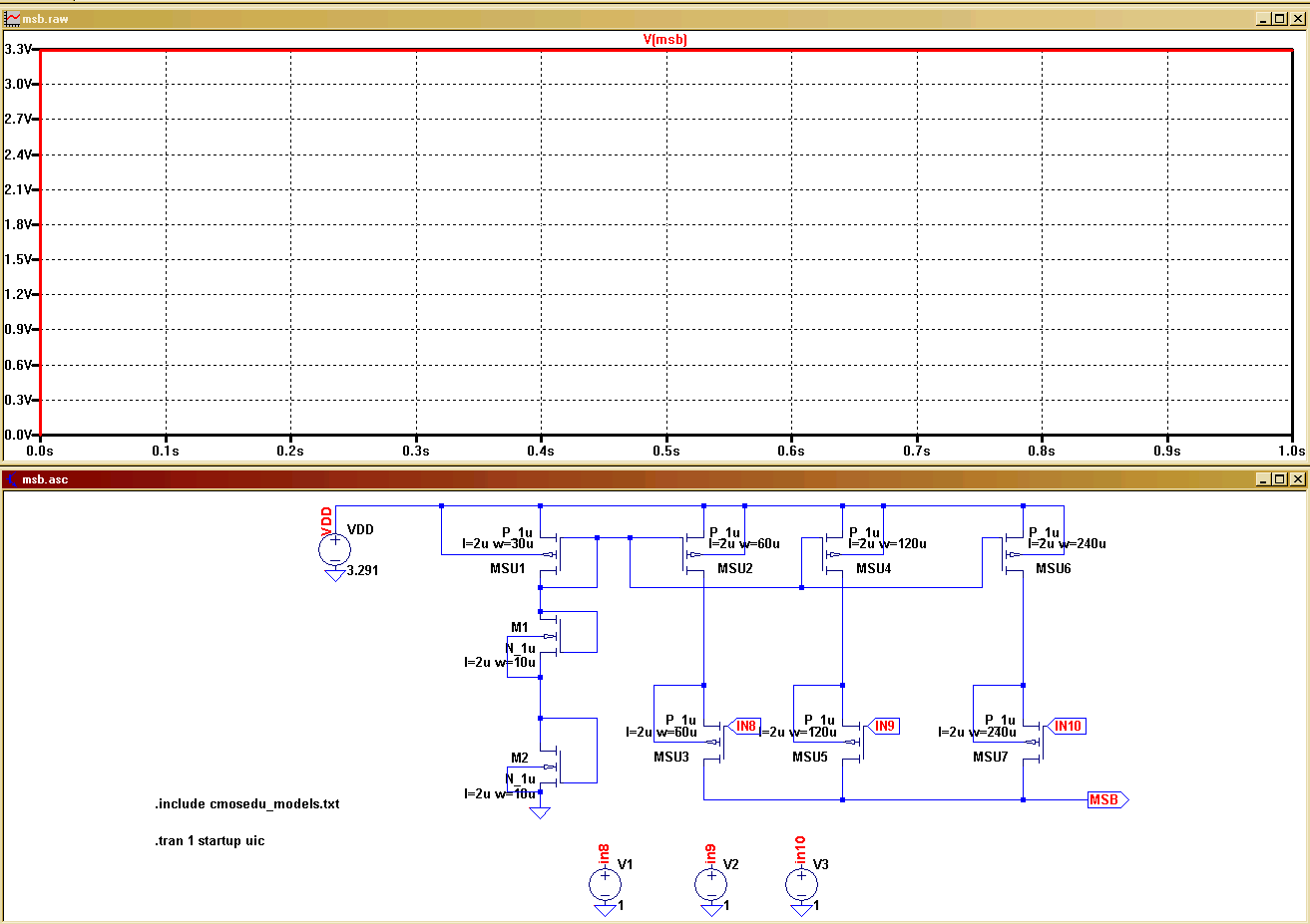

i have designed a circuit designed in LTspice as attached with my txt file. When i want to run my design, it poped up with "Singular Matrix: check node in8 Iteration no1"
How do i fixed this error.

hi 36,
Inputs IN8, 9 and 10 are floating.??

Added dummy IN8,9,10

hi thanks for ur help. could u mind share me the asc file that u edited.
hi36,
Attached the asc file.
The voltage value of 1v is an arbitrary value, just to keep LTSpice happy.;)
You should assign the correct voltage and signal type as required to in8,9,10
