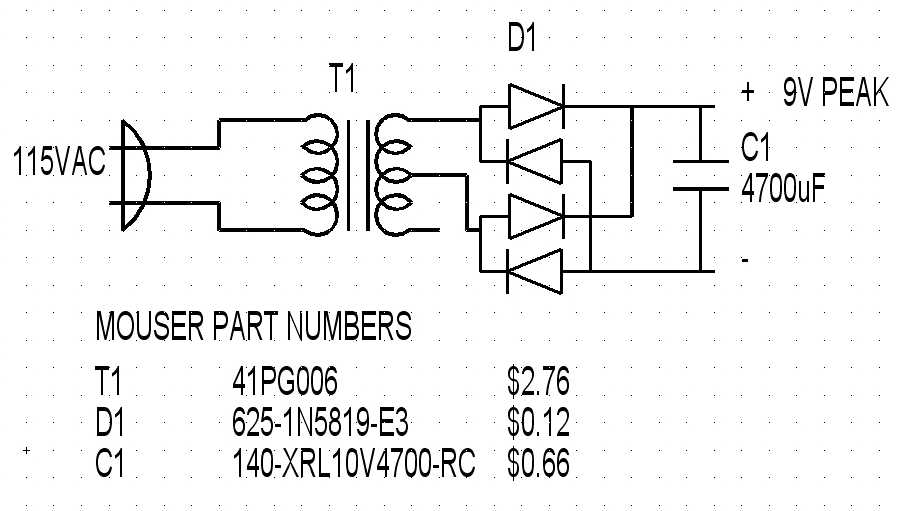

Ideally I would like to be able to power multiple touch circuits from a single AC-DC transformer with a regulator to smooth out ripple etc.

The key is, that the negative and positive of the battery cannot be common. A transformer with multiple secondaries and rectifiiers (one for each circuit) is all that you need (or multiple transformers). That would be a custom design.
ah ha.. thanks! i've never designed a transformer circuit so will have to do some research.. maybe a stupid question, but is it possible to use secondary DC-DC converters instead of secondary AC-DC? or would that still result in a common ground?

The simplist solution is multiple transformers, this is the circuit. Parts are available from Mouser https://www.mouser.com. The capacitor, C1, is probably not needed for your application. You could use the whole secondary but the output voltage would be double (about 18 volts).
thanks, i haven't mentioned i live in new zealand.. would this be a good alternative?
12.6V CT, 150mA 2VA Centre Tap - Type 2851 Transformer
also, would there be much fluctuation in the output voltage?
