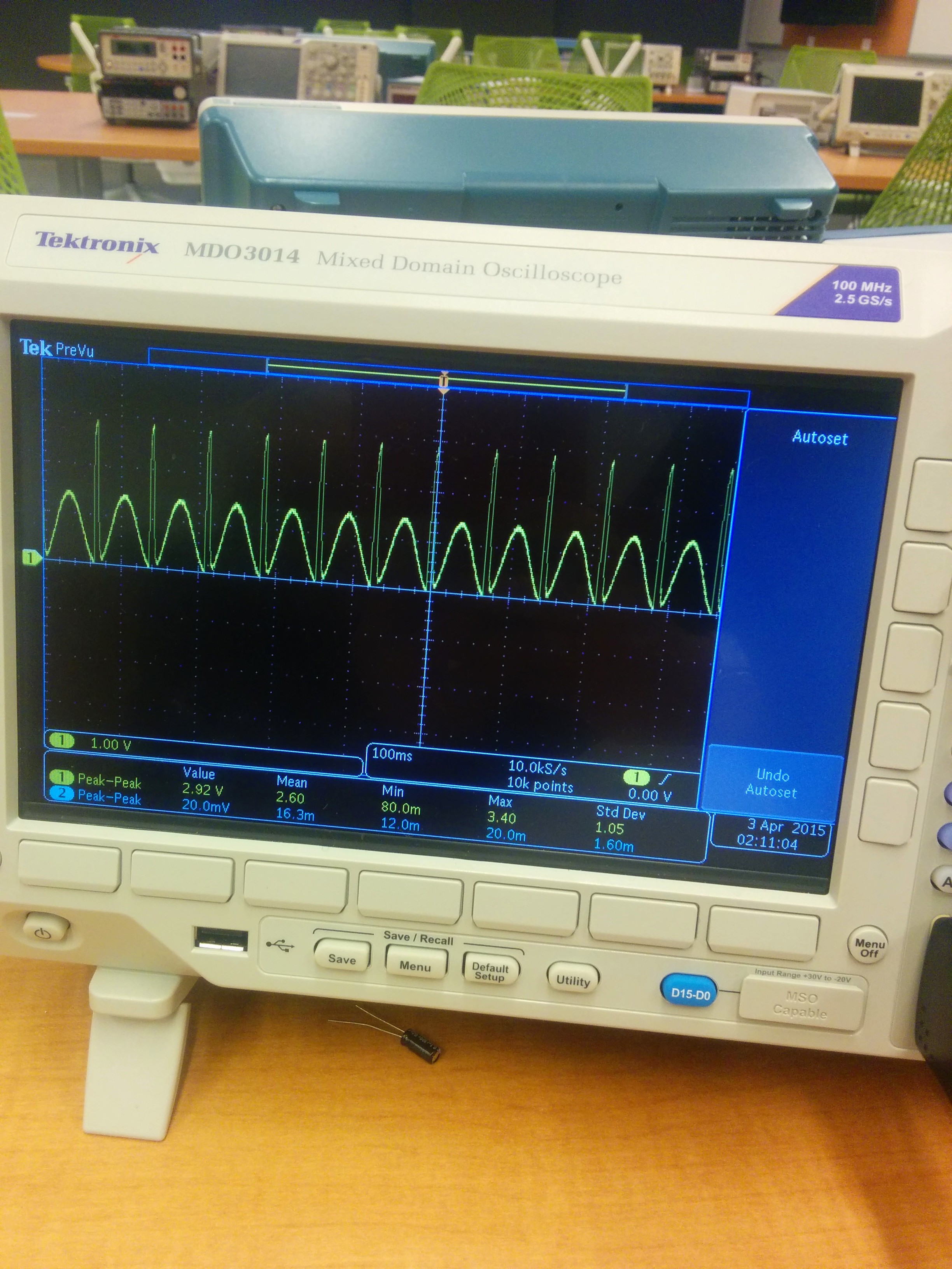

So now I tested the code and the output of the pwm after the filter has that shape shown in the attached image
My questions now:
1- Why are those spikes formed and how can I get a smooth sine wave?
2- It is a control method so I need to add an interrupt to the code with a specific time/Frequency to adjust the frequency and amplitude of the wave but I don't know how to make this. (the delay works but whenever the code changes I still need to adjust the delay besides I need to get a more accurate frequency)
Thanks in advance
Actually that looks like the waveform is trying to go negative (below 0 pwm) and rolling over to max PWM.
Perhaps your min PWM needs to be error checked.
