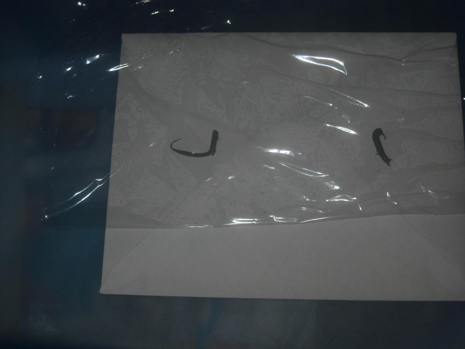

A few hours ago I posted my comment lamenting the fact that expensive solder paste has a very limited shelf life. Your trick will bring a few extra weeks of that valuable paste.
Would it be possible to freeze it for even longer life?
Good question, and what i found on the web doesnt help much.
What the sites all say is DONT freeze solder paste, but they NEVER say why not or what happens if you do.
Solution? I'll have to test some myself, since no site i found actually tested this idea out.
I'll freeze a few small samples in a little while and let them stay in there over night, then test one sample for solderability after say 24 hours then another sample after a week. Of course i will allow plenty of time for each sample to come back up to room temperature before trying to solder with it.
That's unless someone else can find some good information about this idea first.
LATER:
Two samples in the freezer now (see pic).
Those two small samples could be used to solder maybe four 8 pin SMD packages.

I understood that the reason to wait for the solder paste to warm up before using it was to avoid condensation forming on the paste. I'm not sure how important that is, but I don't think that squeezing a bit out to let it warm up will avoid condensation.
Well i have two ideas on this.
First, in my case, i would be using it fast enough anyway so that condensation would not have much time to form.
Second, in the case of the small sample squeezed out, then perhaps it could be covered with plastic wrap while it warms up.
Also, the plastic wrap can then be inserted into a glass of warm water to help heat it up faster.
Since i already have the two samples in plastic wrap, i'll just cut one sample away from the other and let it warm up naturally at room temperature. I'll see how it works after that.
I probably wont try the first sample as soon as i though but wait a bit longer, maybe a couple days depending on what else is happening around here this week.
