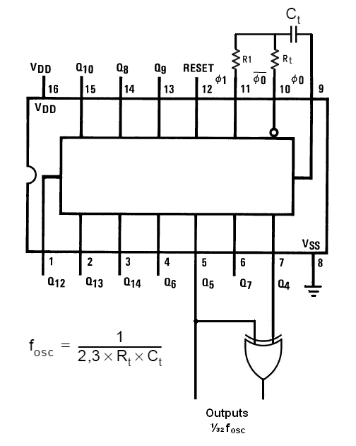

Here's another digital idea:
You could use a two-bit counter and oscillator.
The XOR of both outputs and output B is quadrature.
This could easily be implemented using a CD4060 and an XOR gate.

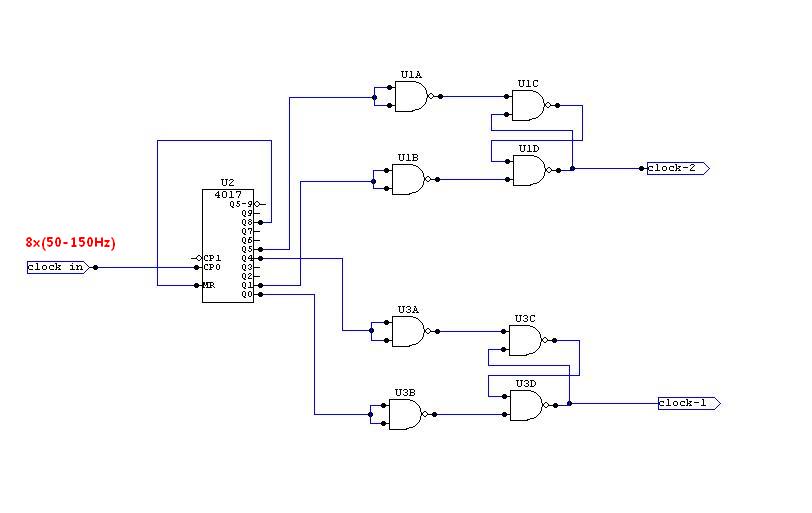

try the attached circuit, you need 8x (50-150Hz) to feed it the output would be 50-150Hz two clocks with 90 deg phase shift.
That's a little complicated isn't it?
I've drawn up my idea which is much simpler.
The XOR gate can be made from a quad NAND, if you don't have any XOR gate ICs.
you are correct with the truth table, and if you have A&B signals you can get as required. also i made a mistake on my diagram that its 45 phase shift not 90, small change on pin connection would offer 90.
you have to connect the reset of 4060.
