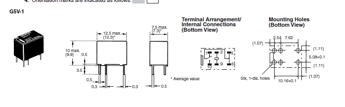

It might be best to use your 12 volt bell as a trigger. Connect the bell to a small relay (eg Omron G5V-1-12DC, from Mouser electronics or elsewhere). Here is the pinout for the relay.

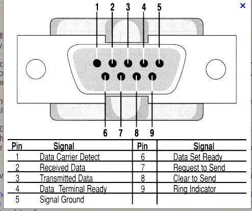

The relay output can be connected to the RS-232 port. Do not use pin 2 (Receive Data) or pin 3 (Transmit Data). Perhaps use pin 1 (Data Carrier Detect). Here is the pinout

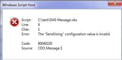

I tried running the script on my computer (Win7), but I am getting an error message
Does the script utilise an existing email application that has to be open? (I am currently using Windows Live mail)

That could be a problem. The CDO method will look for a SMTP (Simple Mail Transfer Protocol) to send the message. Windows 7 isn't a problem as I am running this script on Vista, Windows 7 & 8 and have run it on XP. There is another script you can try:

Update the fields in red to look like my example and put in your information. Let's see if this works.

Now without clicking the Phone Home button and leaving it disabled just run the program. Try jumping Ground (pin 5) on the RS 232 port to pins CTS, DSR and DCD pins 8, 6, and 1 respectively. You should see things happen. Let's make sure that much works.
The pins are Digital In, the must be a 1 or 0 with 0 being a grounded pin! Whatever is interfaced to these pins must provide a logic low.

The input coil to the Omron relay is not polarity sensitive. So you you could connect Relay pin 2, to the +positive side of the bell. Connect Relay pin 9 to the -negative side of the bell. the 'normally open' contacts of the relay are pins 1 and 10. Connect relay pin 1 to RS232 pin 1 (if you are going to 'monitor' the DCD status). Connect relay pin 10 to RS232 pin 5. In operation when the bell is energised, power is supplied to the 'coil' of the relay. This 'closes' the 'Normally Open' contacts of the relay. In effect, you are now providing a ground to pin 1 on the RS232 port.

I have now tried your original (short version) script from my home computer and it worked fine there. My home computer is running Vista, with Windows Mail. The home computer email does uses SMTP. My work computer is the Win7 machine with Windows Live mail. The work machine is a 64-bit O/S but that shouldn't make a difference. I hope to run the application from home, so all is good (I will try your second supplied code on the work computer when I get a minute).

Thinking back, I had that error. Not from home but when I tried to run it at work through our email server. This is an excellent write up on the subject and note where he gets into servers. The CDO replaced the old CDONTS on everything since Windows 2000 and Windows XP.

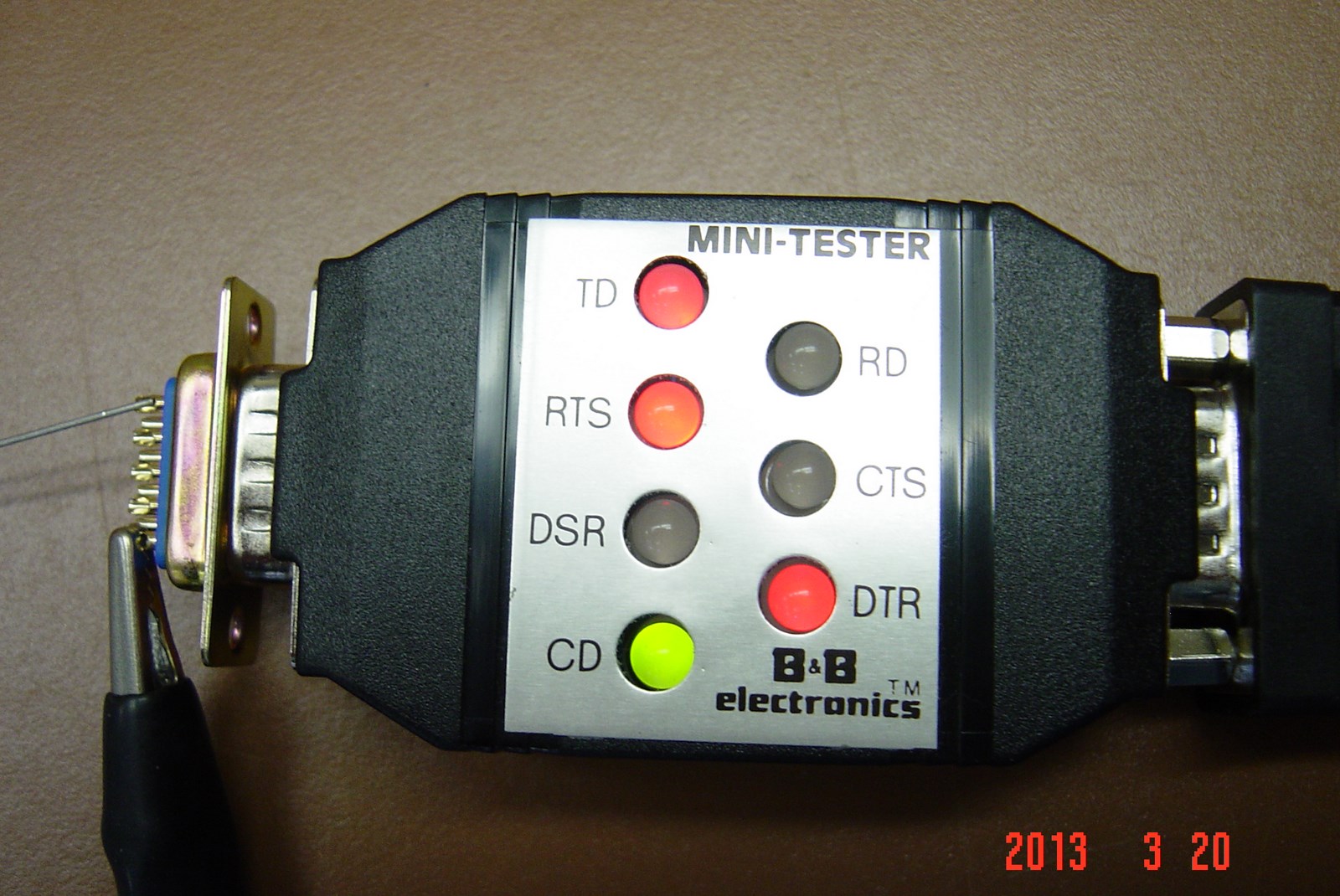

Using a voltmeter, I noticed that pins 1, 6 and 8 on my serial port were already at 0 volts with nothing connected to the port. Using a 12 volt bench power supply (via a series resistor), I touched each pin and the software does detect it and changes from green to red (low to high). Therefore, the trigger circuit has to provide the transition from 'low' to 'high'.
I would think that is why you are having trouble reliably triggering the software Greg. Also Greg, I'm assuming your bell trigger is off of a home-type alarm panel? If so, you wouldn't even have to use a relay. You could connect a wire directly from the positive (+) side of the bell, to the RS232 port pin. I would suggest using a resistor in 'series' with that wire, just to provide some isolation to the port. I would suggest using a resistor of say 220 ohms to 1K (1000 ohms) - I tried both resistor values in my test setup and each worked ok.

BTW, these little RS232 testers are handy if you do much work with serial ports. They are available in 9-pin versions for DB9 connectors, and 25-pin versions for DB25 connectors. Some have LED's for all pins; some have LED's only for the commonly used pins.
