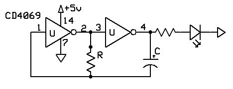

Hello, I am working on a simple oscillator that uses two inverter gates, a resistor and a capacitor. I planned this out a while back, but I cannot find the formula I used to calculate the frequency. I also can't find anything online that resembles the circuit that I am using and also gives a formula for it. Can someone help me out here? I attached the schematic.

You may want to add one more inverter as a buffer to the LED separately from the feedback or the LED loading will effect the oscillator frequency, how much I don't know.
I would assume that the following would be correct:
F = x/(RC)
Just build the circuit and measure the frequency. Then you can calculate x. Then you can calculate the rough frequency for any RC.

Actually, before you give up, have a look at
You will note that there is an extra resistor used, Rp, to 'protect' the CMOS input. It also has the added function of preventing the capacitor from being discharged through the CMOS input diodes (this affects the duty cycle & frequency, so the above f=x/r/c is no good due to the diodes affecting the timing)
Rp is just a high value resistor 100k to 1M is normally good enough.
