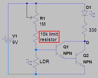

ok... it works but i would like it to come on when it is darker than what it does now (stronger resistor) i used a 100k pot, i would also like it to be brighter (i used a normal, small bulb)

Use a pot with a higher resistance, add a high value resistor in series with the pot or replace the pot with a higher resistane value resistor.
Didn't you use a 2V red LED? Is the 9V battery new? The 330 ohm resistor sets its current to about 19mA. replace it with 220 ohms and it will be as bright as it can be at 29mA without burning out. If it still isn't bright enough then get a brighter LED.
ah thanks, i took away the pot and added a 1m resisor and that is ok, but i will try what you said because i wanted it to be adjustable, no i used a normal bulb, i'm going to replace it with a white LED or an orange one

You are correct, you needed more resistance than the pot. If you want it adjustable then use a 1M pot.
A white LED has a higher forward voltage than a red one so the 330 ohm current limiting resistor should be 180 0hms. If the orange LED is 2V then use 220 ohms.
i wondered where the diagram had gone lol, can't i use a resistor and a pot in series then? i thaught this would just lower the range of ajustability if that makes sense

Yes you can, and it's generally a good idea.
The resistor in series with the pot limits the current so the transistor doesn't blow-up if you turn the pot too low. Here's my corrected sketch:

Of course transistors will burn out if too much current flows through them. You replaced R1 in the original circuit with a pot. When you turned down its resistance to zero then all the current from the battery flowed through the input of the trasistors, causing them to heat. Your transistors or pot might be damaged.

The 330 ohms resistor in the circuit is designed to limit the current for an LED, not a light bulb. Remove it and if the light bulb's current is within the rating for your transistors then it should light to almost max brightness.

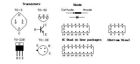

Do you have a picture of the transistors from their datasheet so you are certain which of their wires is emitter and collector?

here is what i used for transistors (my ones are the bottom left)

Since you have only 10k instead of a 1M pot or resistor, it will take an extremely bright light shining on the LDR to turn off the transistors.
Just think about how an LDR works: the brighter is the light then the lower is its resistance. You might not be able to find a light that is bright enough.
Try it with a 1M or more resistor and I'll bet it shuts-off with moonlight!
