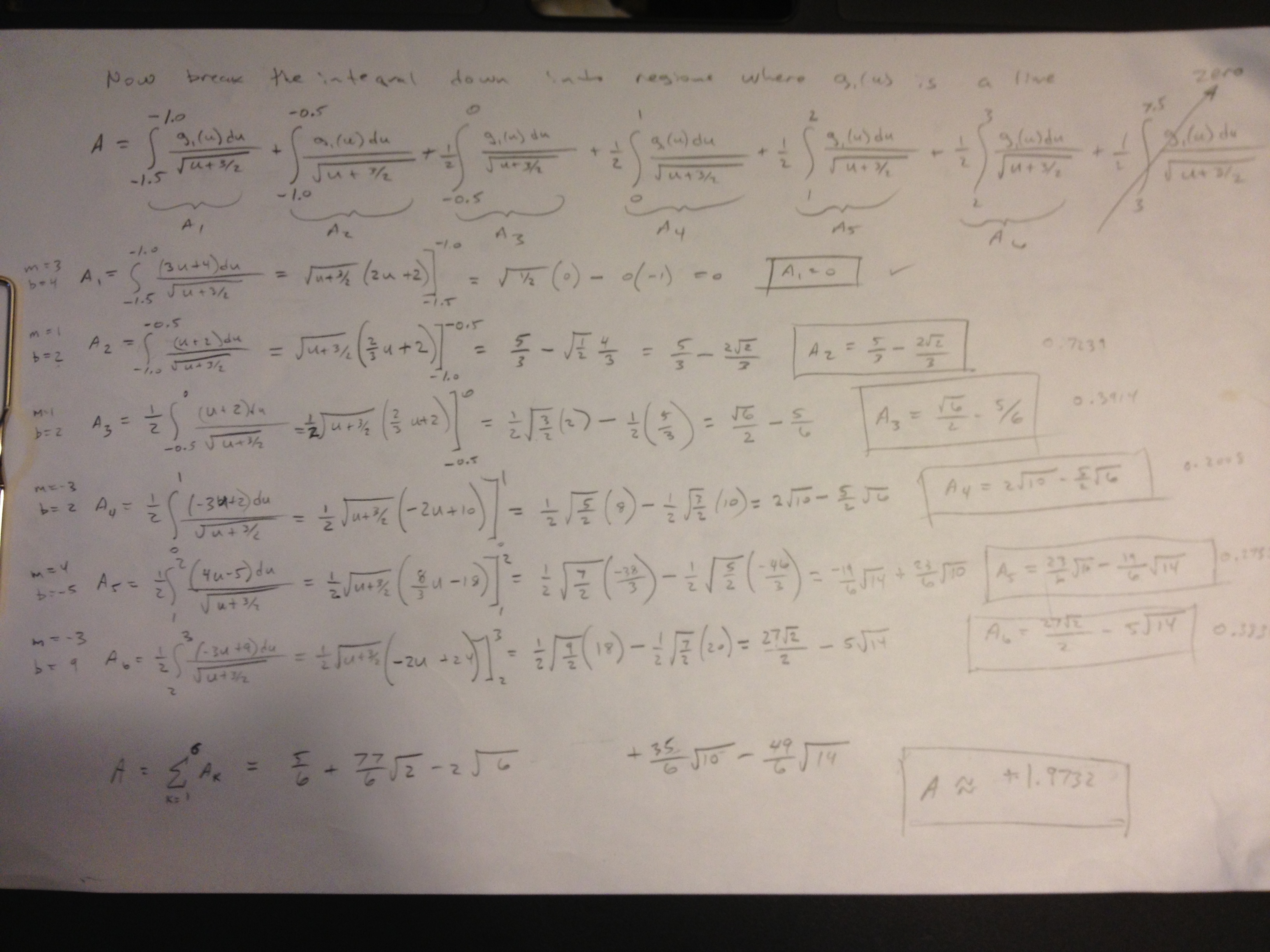

How about one more, a little more tricky but lets see what happens...
Instead of g4=g1((t-3)/2) or the last, try using g4=g1((t^2-3/2). This is a non linear u this time.
OK, I worked this one out. It seems to work and I get 1.9732 as an approximate answer. I've attached 2 pages of work which also contains the exact answer. Then the 3rd page has a check of the answer using direct integration, with a Matlab programs to quickly handle the details.
I have to say that I would not normally have taken this substitution approach for this particular problem. Actually, the method I used to check the answer would have been my preferred approach, as that one only took a few minutes. The substitution method took me over an hour! However, it is useful to check it out and make sure the method is general. The method seems OK as far as I can tell.

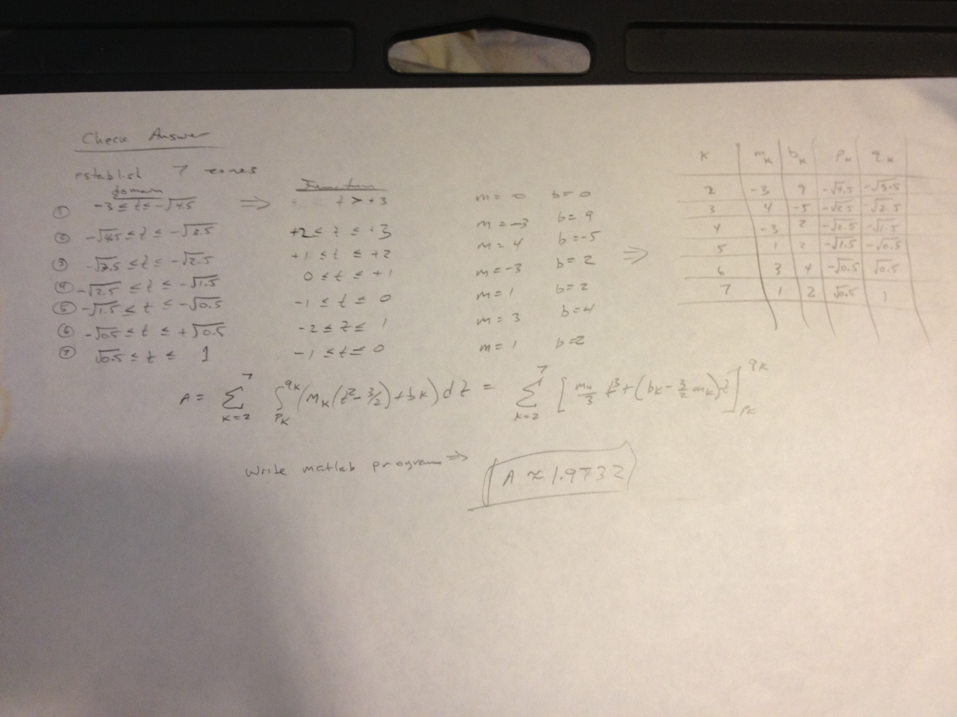

The Matlab code to check the answer is as follows.
m=[-3 4 -3  1  3    1   ];
b=[9 -5  2  2  4    2   ];
p=[-sqrt(4.5)  -sqrt(3.5) -sqrt(2.5) -sqrt(1.5) -sqrt(0.5) sqrt(0.5) ];
q=[-sqrt(3.5)  -sqrt(2.5) -sqrt(1.5) -sqrt(0.5)  sqrt(0.5)    1      ];
for kk=1:6
    A(kk)=((m(kk)*q(kk)^3/3+(b(kk)-3*m(kk)/2)*q(kk))-(m(kk)*p(kk)^3/3+(b(kk)-3*m(kk)/2)*p(kk)));
end
sum(A)

Hi Steve,
Wow, it looks like you really did a lot of work there. It wasnt my intention to have you do that much work i thought you would just throw the regular u substitution at it and see what we get, similar to before. Im not entirely sure what you actually did there, maybe you could explain it in words.
But did you at least try this numerically? Try that and compare results. I think you'll find a significant difference. Doing it numerically is quite easy if you have a program that integrates numerically. I checked the numerical solution against a raw graphical approach and the results agree quite closely, so i assume the two programs i used were correct because they both matched the raw graphical approach (which of course estimates the areas as a bunch of right triangles as you did previously). It's a bit harder with this one though because the remapping is not a bunch of straight lines but included curves too, but the curves are not too wild so it's not super difficult to estimate them as right triangles.
Would it help to view the remapping plot?
I did it by two methods, and they both agree.
The first two pages use the substitution method. This does get complicated because of the nonlinear mapping.
The third page I just directly evaluate the integral, but I do it symbolically (with help from a Matlab program) rather than numerically.
Have you done it numerically and found a different result? If so, please tell me what number you are getting. If you are seeing a different answer numerically, then I will also do it numerically as a double check.

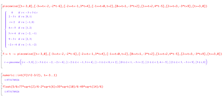

But did you at least try this numerically? ... Doing it numerically is quite easy if you have a program that integrates numerically.
I agree it is easy, and I used Matlab's mupad tool which has numerical integration built in. I've attached a screen-shot of the results and I get the same answer as the substitution method I worked out above.
In the screenshot, you will see that I defined the function using a piecewise description. Then I create a function f(t) . Then I numerically integrate the function f(t^2-3/2) over the range of t=-3 to t=1.
In the last line I enter the exact answer from the substitution method and I convert to a floating point approximation. It can be seen that the answers are equal to 10 decimal digits.

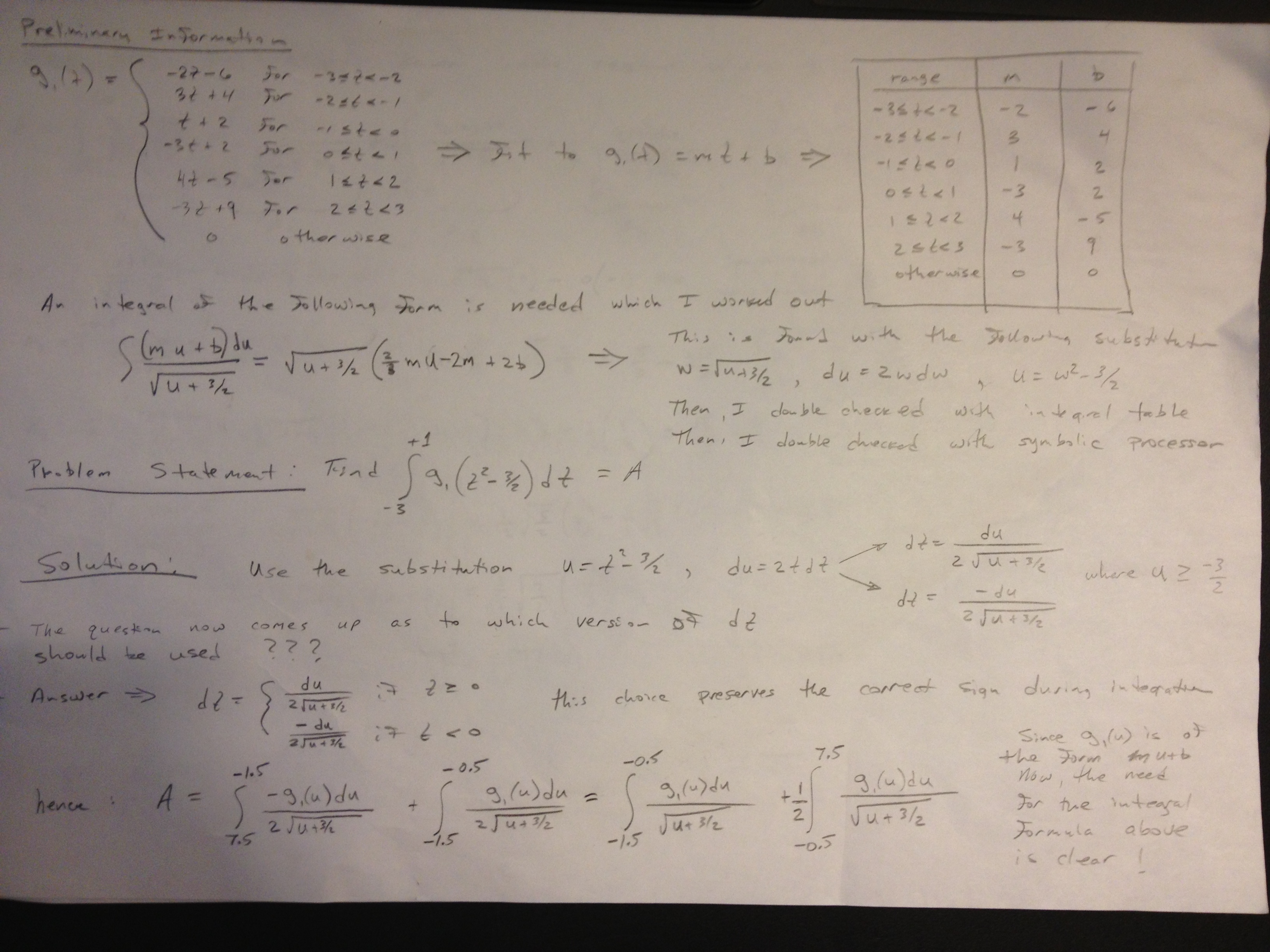

First of all, I am implementing a basic u=t^2-3/2 substitution. There are two things that make this tedious. First, the negative t-axis and the positive t-axis both map to the same u-values, so care is needed to get the formulation correct. Second, the piecewise nature of the function g1(t) requires careful determination of how t-values map to u-values and making sure the correct piece of g1 is used when integrating.
Page 1 Description:
The first page defines the function g1(t) as a piecewise function and then provides a table of domain-range, slope (m) and intercept (b) for each piece of the function.
Then an integral formula which is needed later is provided (note the formula is checked 3 ways to be sure it is correct)
Then the problem is stated as [latex] \int_{-3}^1 g_1(t^2-\frac{3}{2}) dt=A [/latex]
The problem is then solved with a direct u-substitution [latex] u=t^2-\frac{3}{2} [/latex]. There is then a problem determining "dt" because of the square root has two solutions (plus and minus values). So, the dt is defined as a piecewise function depending on whether t>0 or t<0. The new limits for u are then 7.5 to -1.5 as t goes from 3 to 1, but the section from u=-1.5 to u=-0.5 is traversed twice in the range of -1<t<+1. The integral as to be carefully written out and simplified as shown at the bottom of the first page.

The third page, does a direct symbolic calculation of the integral. I could have done an exact calculation here also, but I cheated and used a Matlab program to work out the math numerically and just provide direct verification that the answer on page 2 is correct. If page 3 is too confusing because of the compact notation, then just ignore that and use the numerical integration that I did in the follow on post. Basically, either method gives a numerical answer that validates the answer on page 2.
