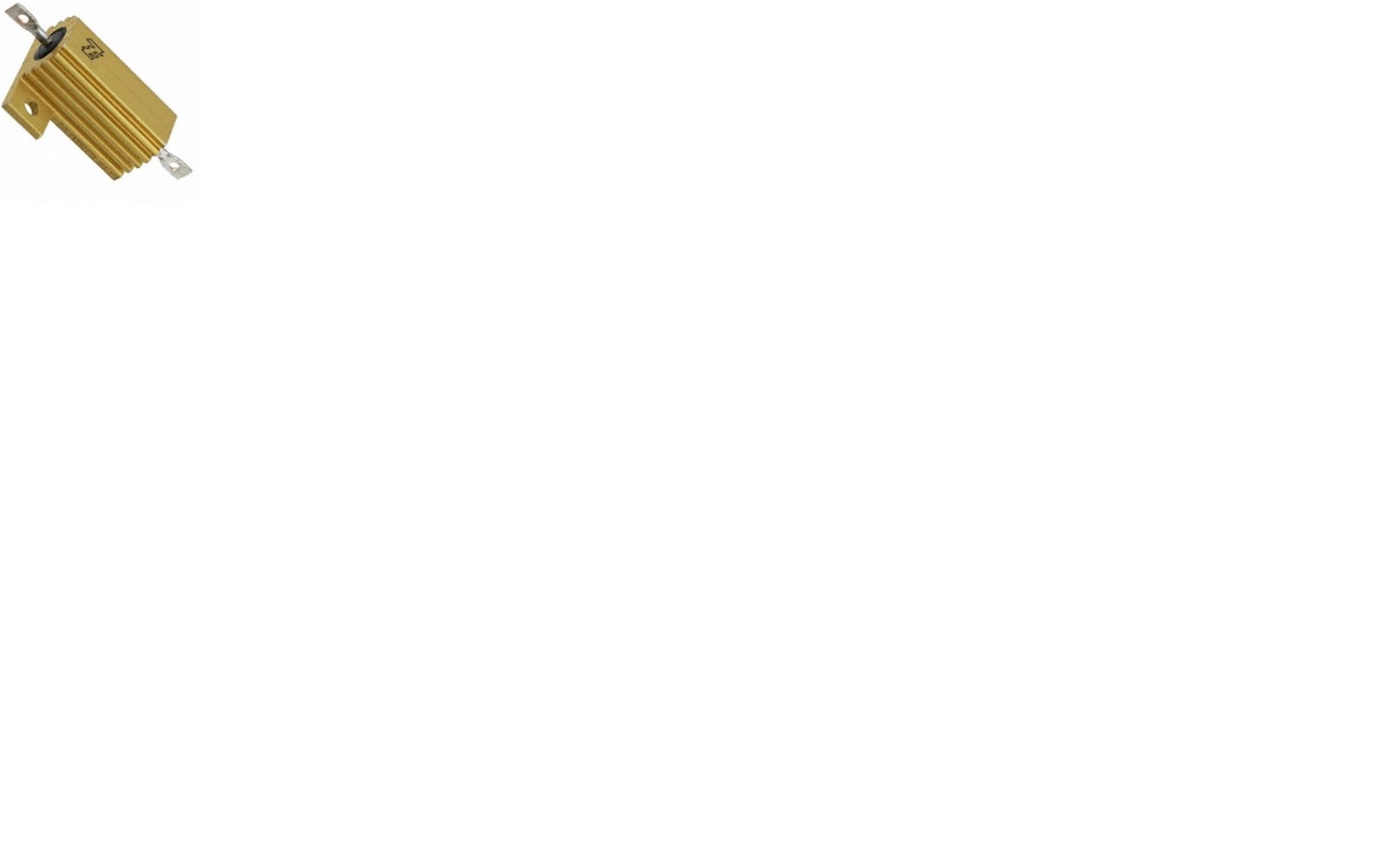

Maybe a power resistor would suit your application better.
a 25w or 50w power resistor in the metal package has a smooth surface made for a heatsink (they won't dissipate 50w unless installed on a 1 foot by 1 foot aluminum plate). Depending on your voltage source, you can pick the correct resistance to yield the amount of heat you need, from warm to HOT HOT HOT. You only have to dissipate about 1 w to get it very warm indeed. (I just did a project where I dissipated 2.76W into a 3W resistor and it gets very toasty, but doesn't burn up).
this resistor is about $3.50 from digikey.com: A102430-ND
