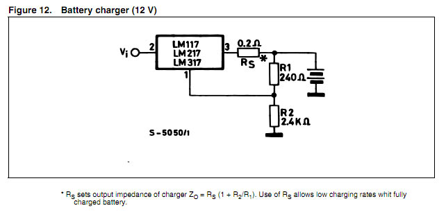

You can also use a simple LM317 current limiter, check the web, there are tons of those simple circuits posted!
-Ben
Ben, Thanks mate!
But wouldn't this not work considering these style units require an input that is higher than its output. 2v or something drop accross a regulator like this one? Meaning my 13.5v input wouldn't be able to output (with a LM317) enough to charge the Battery to 13.5v? It sucks :( Because my Power supply is about 13.5v and I want the batter at 13.5v but don't want to just connect the two together without limiting the current to the advised amount for the battery at hand...

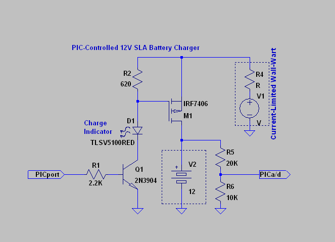

You need a current-limited full-wave rectified output wall-wart which has an open-circuit voltage of 15 to 18V, but is current-limited to less than 0.5A (more like a constant-current supply, less like a voltage-regulated supply). A trick that works for me is to find the Wall-Wart with the right output voltage, and then connect a 24V 10W lamp in-series with the 120V input side of the wall wart (I break open the plastic case of the wall-wart, and repackage it into my own enclosure). The lamp acts as a "ballast", or crude current regulator. The non-linear filament resistance is what accomplishes that.
I use the A/D inside the PIC to monitor the battery voltage. When the battery needs charging, the charging cycle consists of turning on a high-side PFET switch which connects the wall-wart output to the battery positive pole. Since the wall-wart is current limited, the PFET is just a switch, fully on or fully off, so dissipates almost nothing. (Heatsinking not required).
The PIC watches the battery terminal voltage during charging. When the battery voltage reaches 14.7V, it keeps the charger on another 15min (regardless of how high the voltage climbs during that 15min period), and then switches off the PFET.
The PIC continues watching the battery voltage, and turns the charger back on if the battery voltage sags below 13.3V. This time, the charger turns off upon reaching 13.8V. This cycle repeats until the battery is removed. When the battery is disconnected/re-connected, the PIC goes thru the initial charge cycle again, including charging for 15min past reaching 14.7V.
If you are in a 240V country, you may have to find a different lamp to use as a ballast ahead of the wall-wart. Maybe a 120V lamp (if you can find one)? You know you have a lamp with the right filament resistance when it glows about half brightness early in the charge cycle, and then glows very dim toward the end of the charge cycle.

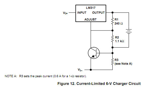

Mike, just looking at it again, I could theoretically use your idea there but replace the current limiting portion with the LM317? See attached? Obviously powering from a 24vDC source.

I don't like that LM317 circuit. It There is **broken link removed** that uses the battery charge current to create a voltage drop across ~1 Ohm resistor to turn on the Vbe of a small NPN transistor. The collector of the NPN pulls on the LM317 Ref pin. It has a much better I/V characteristic for battery charging than the one you posted.
So this one here would be a winner? I guess I would have to use a 24vdc PSU and regulate it down to 16-18v or something like that? And have a separate regulator at ~14v for when it is not in charge mode and simply powering the device across the battery?
I guess now I just have to figure out what the resistors and whatnot are

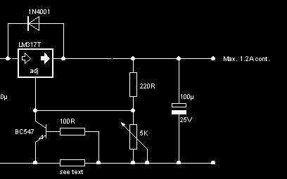

hey, I was just messing with this circuit **broken link removed**. I'm feeding it 19v and have it configured exactly as the diagram is minus the 25v 2200 cap at the beginning and obviously a SMPS infront of it instead of that linear rectified PSU.
And I can't get more than 10v out of it. 5k pot, even tried winding up the resistance on the pot with a 20k pot and nothing more than 10v. What could be causing this? Maybe no load? I just have an led on the output so I can see it on and then the multimeter to check the voltage as the text says. Any ideas?
