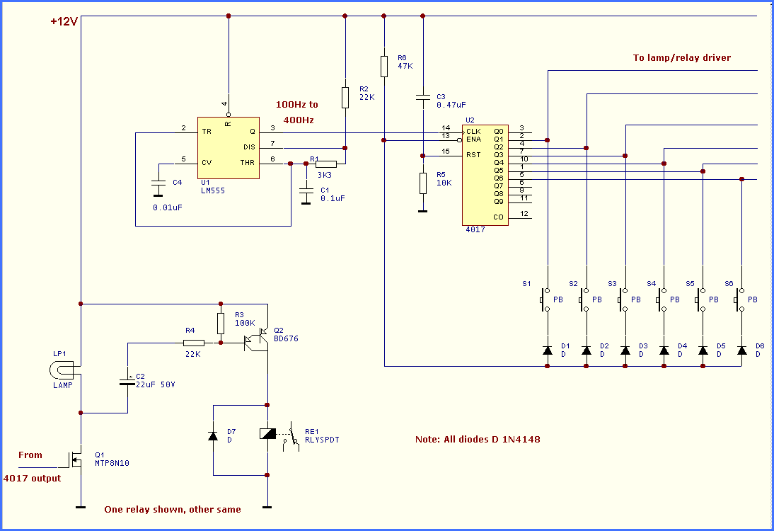

A clock source is generated by the 555 timer, or if AC is available, the rectified 50Hz(=100Hz) can be used as a clock source instead so no 555 timer needed.
The 4017 is RESET upon power up and stays at Q0 state. Notices that its enable pin is pull HIGH so it will not count. As soon as a push button is press, the enable pin is pull low and the 4017 start counting. The clocking frequency has to be fast or else the lamp/relay would starts to operate.
The 4017 will stop counting when it reaches the output on which the push button is pressed. Its logic HIGH output will then drive the lamp driver and relay circuit. There is a capacitor at the relay driver PNP darlington transistor base pin therefore the relay will only be on for a brief moment and then released. The timing is controlled by the value of the capacitor.
I hope this circuit serve your purposes. If you need part values, just ask.

Ron H said:
Eblc1388, nice! I think you need to move R1 or C1, though.
Ron
Yes, my mistake. Capacitor C1 should be connected to 555 timer pin6 and 0V instead.
Thanks Ron.

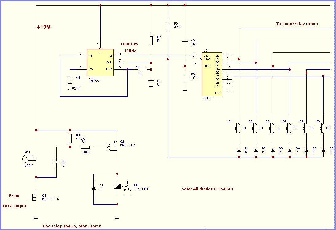

I really appreciate the drawing - as offered, would you be able to put values/codes to the components that are missing them including the PNP Darlington junction, and the MOSFET and if you could also suggest a value for C2 to provide around a 1 second timing that would be great.
I appreciate your description too, from it i can understand how the circuit operates and that is important to me if i am to learn anything.

The n-ch MOSFET can be any suitable type with current of a few amps or more. This also applies to the PNP darlington. The problem with typical part numbers is I don't know where you are located and sometimes it makes a big difference.
You can select them from catalogue of your local component shop and post back the part number if you are not sure if it would fit.
Usually the schematic would not show power supply pins connections and decoupling capacitors. You have to get the datasheet of these ICs from the internet and connect them up correctly. Remember to add 0.1uF capacitor across each IC's positive and negative supply pins, as close to them physically as possible.

Thanks for the reply - i tried to find the MOSFET you suggested in the diagram but i couldnt find it anywhere. I think i found an alternitave, its a IRL510 - RS part number 189-0438. Would this one work?
