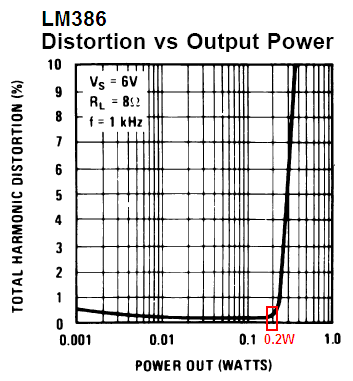

The LM386 isn't very powerful. With a 6V supply and an 8 ohm speaker, it produces a whopping 0.2W at clipping. With a higher supply voltage its output power is more, but it might melt.

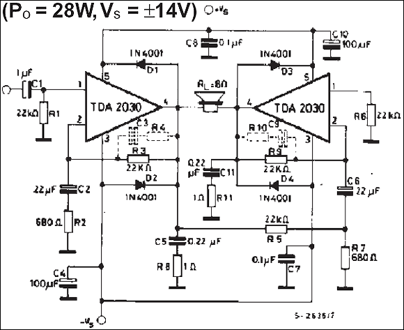

TDA2030
I don't know if this is cheap but it's not a complex schematic and manage your 25W requirements.
25 Watts would turn a typical little computer speaker into smoke.
