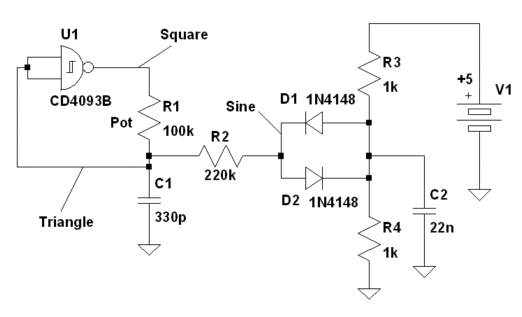

looking for a no thrills signal generator literally just to learn from and use with oscope
How about this? Dead simple. Gives square, triangle and sine (approx) outputs. Frequency up to at least 1Mhz.
