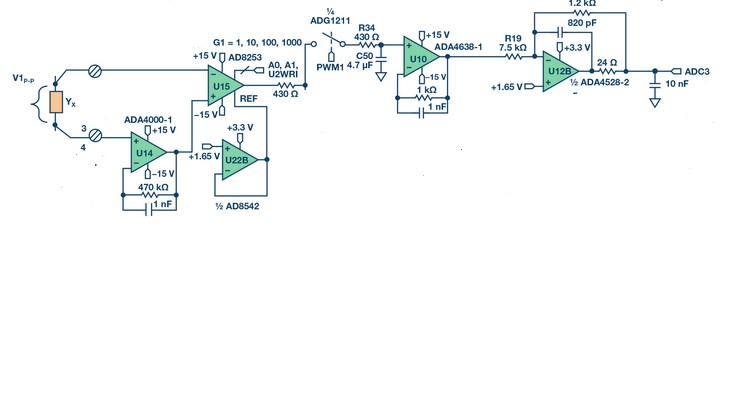

Please see the attached circuit. Can this be circuit connected to sigma delta adc. Does the reference voltge of the sigma delta adc needs to be the same as the comparator input 1.65V. I highly appreciated if you could give me idea about this. Thank you.
The output amp, U12B, is clearly offset by 1.65V, 1/2 its supply V. You can connect
your DelSig either single ended , ADC is essentially unsigned output. Or if it has
differential input use the 1.65 as other input to ADC creating a signed output
for the ADC.
Are you trying to do CDS ? Correlated Double Sampling ?
Not knowing the functionality and design requirements of the signal path cannot
comment further. I see you are sampling the input and then LPF the output, but
thats about all.....
Regards, Dana.

Thank you for the reply. I am trying to understand this circuit. This circuit to be use as low current amplifier.I dont get why 1.65V is applied as a reference for the U15. What I understand is 1.65V added as offset of the output voltage. Please correct me if I am wrong. Thank you
Would be used to maximize the dynamic range for the sensor, not knowing what
the sensor is rest is a guess.
Regards, Dana.
there are no comparators in the first schematic. What exaxtly are you trying to ask? Also, which adc are we talking about?
Yes there are no comparators in the first schematic. I wanted to use this circuit as a low current sensing. And feed the output to sigma delta adc (MCP3553). Looking at the circuit I dont think I need U12B. Can I just use the output of the U10 and feed it to sigma delta ADC input(MCP3553)

I wanted to measure the current of a sense resistor which will be in mili amps.
what is the value of the resistor and what is the accuracy you want to achieve?
A current of 1mA will give a voltage of 1,800V. Something is wrong with your figures.

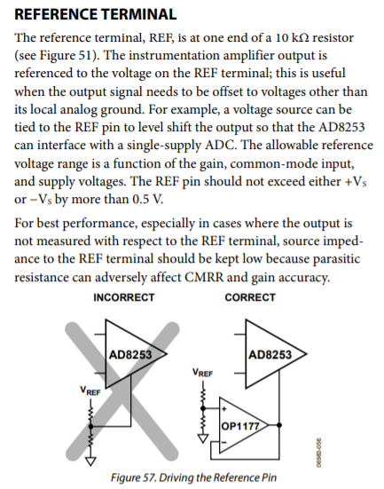

Thank you for the reply. Since this is going to be low current measurement. Does U15 Reference voltage needed because the offset creates errors on the output of ADC. Am I correct about this.
I don't know the value of it but probably in the order of magnitude of 1.8 MΩ
I don't believe you need anything after U15, or possibly U10 as a low pass filter with the analog switch bypassed?
The sigma-delta ADC uses a switch capacitor input circuit that acts as a sample & hold.
Connect input high to the opamp out and input low to the mid-supply re (U22B). That circuit is configured to work with either polarity of current in the sense resistor, so "zero" is half supply, to give the widest range either way.
The ADC reference should be set to suit the maximum input range needed.
U22B input is presumably shown as 1.65V on the basis the circuit feeds an ADC operating on 3.3V
Use 2.5V (again, half supply; two equal resistors and a cap to analog ground) instead, if the ADC will run from 5V.

I'm guessing [hoping] you meant
"probably in the order of magnitude of 1.8 mΩ" - Milliohms, not Megaohms?
As shown, that circuit can only work as long as both ends of the sense resistor stay within the common mode range of the opamps; less than +/- 15V.
If you need a wider range, you need a different input circuit.

Thank you for the reply.I meant Megaohms to measure
It's rather vague and confusing about exactly what you're trying to do?, but you might try googling for 'current ranger', which is a device for measuring tiny currents, without losing too much voltage across the sense resistor. It's also open source, so all the details you need are there.
