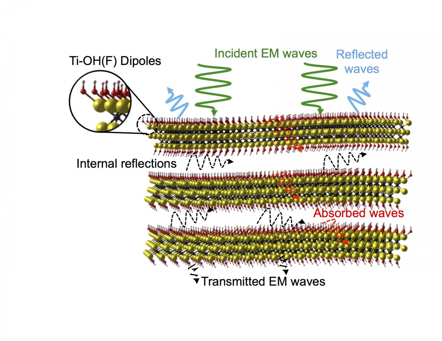

MXene rf shielding film. Here are a few links.
There are dozens of different types with various characteristics.
Search for MXene rf shielding film, for many results for the last couple of years.
Sorry for the 1st recommended search suggestion.
Enjoy.
that can prevent the passage of an electric field and a magnetic field....stop all EM fields.
Nowhere does it make any claim that it can stop magnetic fields.
They are EM - Electromagnetic - shielding materials, which the article itself compares to such as copper shielding, just much thinner and lighter.
It is NOT "Magnetic" shielding, that would be a totally different thing.
EM shielding blocks photons and electrostatic fields, not electrical current (the material conducts) or magnetic fields.
Other than the "switchable" ability, if that works as implied, it does just the same as a coating or layer / sheet of metal shielding would do.
