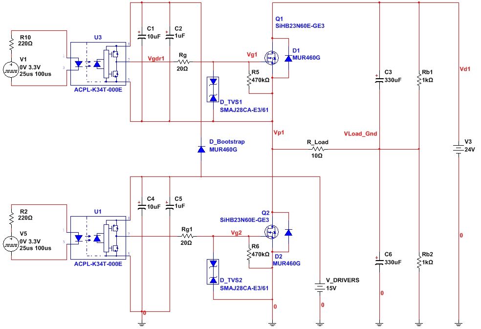

I'm having a problem with an isolated half bridge driver circuit where the gate driver keeps failing.
I'm trying to use two "Si8261BBC-C-IP" isolated gate driver ICs to isolate the MCU from the MOSFETs, but the driver keeps failing after less than 1 minute. As soon as I replace the component with a "FOD3180TV", the circuit works for more than one hour. The MOSFETs however are fine as well as the MCU. It's just the gate drivers that keeps on failing, especially the low side driver.
At this stage I'm only building a test circuit which is running at about 50-kHz and a 40 % duty cycle and a resistor as a "load".
I would really like to have someone just look at my circuit diagram and make a suggestion as to what might be wrong or what I might improve on. The problem is that the gate driver keeps failing and I just simply cannot understand why and what is wrong. The output of the circuit (as measured on an oscilloscope) seems to be a perfect square wave.

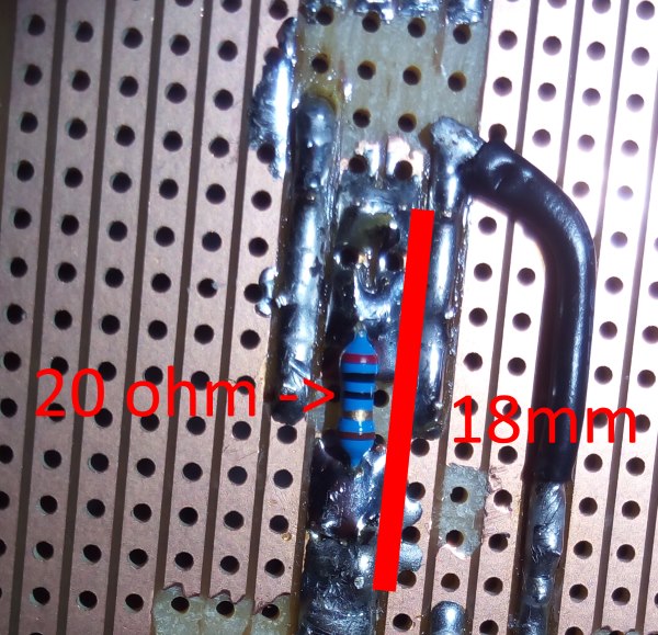

What is the layout like? PCB? Point to point wires? I place the driver very close to the Gate. I think you may have inductance from long wire. This will cause spikes. What is the distance from IC to MOSFET?

Your "28" volt protection on the gate of the MOSFETs actually clamps at 31 to 34 volts. So the protection is not doing anything. (MOSFET G-S voltage must be below 30V)

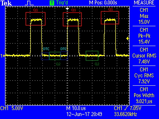

The part number for the actual MOSFETs that I'm using is IXTH48N65X2 and the actual values for the TVS diodes on the gate-source is P6KE24CA. I just used the closest values that I could find in Multisim as I couldn't find the exact part numbers. The PCB traces are on a vero / prototyping board, the driver is about 18mm max from the MOSFET gate pin. The dead time is quite long, for now I'm using a T494 PWM chip to mimic my MCU that I want to use. Since my duty cycle is 40%, the actual time in seconds should be 200 microseconds. I haven't measured the voltage across the 20-ohm resistor, but I think that should give me some idea of how much current is flowing?

There is no crossover problem. Good.
I think the way you have it:
Q1 = on Q2 = off
Q1 = off Q2= off
Q1 = off Q2 = on
Q1 = off Q2 = off

I must agree with ronsimpson about the need for a 0.1uF cap close to the power supply pins of each driver. You show a 1uF and a 10uF cap, but they're shown as polarized parts, so I assume that they're electrolytics
While lower in capacitance, the low equivalent series resistance, impedance and inductance characteristics of ceramic capacitors do things that their higher value electrolytic and tantalum cousins just can't.
And, although we usually think of them as decoupling caps to supply supply spikes of current when a change of state in a chip increases it's demand, they also do a great job at stabilizing the supply rails against voltage spikes due to transients in other parts of the circuit.

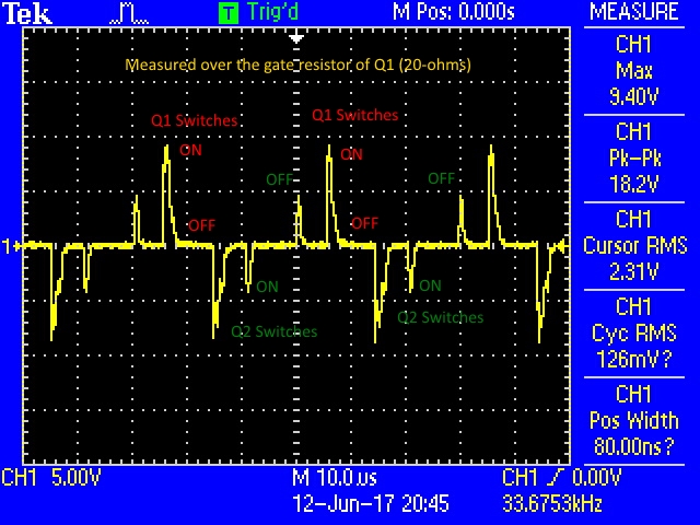

I measured the voltage across the 20-ohm resistor and I saw some very high spikes when I remove the load of the half bridge. This decreased when I increased the load. Peaks reached about 9-10V over the 20-ohm resistor, indicating about 0.5A peaks. The driver states that it can handle 4A peaks.

However something else I'm seeing is that When the low side FET is switching, it's highly detectable on the gate of Q1, causing about 200-250mA to be sink/sourced by its driver, which must not be the case. The opposite is also true. I haven't got the time yet to figure all of that out yet, I'll read through the whole PDF that Alec_t posted sometime tomorrow.
In the 1st image, this was measured on the PWM generator for Q1 (just to show when what switches and the dead time). Then the 2nd image shows the voltage over Q2. It doesn't matter whether its high or low side, they both look the same. I'm assuming this can cause me potential further problems. I'll probably look into it in the coming week.
