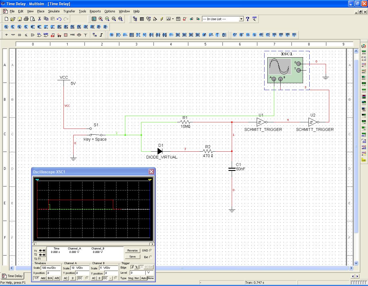

I've just simulated the SCHMITT Trigger on Multisim and it seems to work.
I chenged the 10k Resistor to 470 Ohms to give it faster response and the C Vlaue is 10uF.
This gives me approx a second, What SCHMITT Trigger would you recommend and invertor?

470:eek:hm: is much too low. 2 reasons:-
  1. It means you have to use a large electrolytic capacitor
  2. The resistor must be much greater than the output resistance of the ST. My recollection is that the Ro of 4000 series CMOS is about 500 :eek:hm:
If you look at the circuit I posted, I used a 100k.
I specified the ST in one of my early posts, 40106, 74C14, etc. The ST can be used as an inverter.

I suggest that you use 10M for the long time so the capacitor will be in the order of 150 nF.
Thus if you make the other resistor 470:eek:hm: the charging time will be about 0.15 * (470 + 60) * 5 = 400 :mu:s.
I have allowed 60:eek:hm: for the output resistance of the PIC i/o.

I placed your values in Multisim and don't come out with the results you expected.
Sorry I forgot to answer the pull in time for the MPS, yeah I agree it is probably much less then 1second but that was the greatest time I would drive the MSP. I agree is maybe as little as 100mS - 300mS but this is something I haven't monitored.
Can you confirm I have done this correctly (see attachment)
I said you need 150 nF. You used 50 nF.

When I used your 150 nF C value it didn't work so I changed it to the 50 nF, I agree I have to monitor the timing of the MPS and operate this at this timing + a Bounce time.
There must be something wrong with your simulation., The circuit will work with any capacitor value.

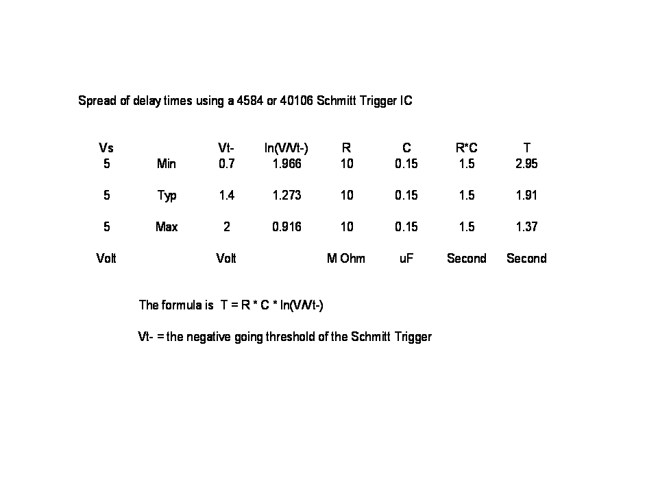

I've posted some calculations of the Schmitt Trigger timer. The 4584 has a wide spread of threshold levels. The negative threshold for a 5 Volt supply is typically 1.4V with max/min of 2 V and 0.7 V. So the delay will vary from one IC to another.

It works but the timeing is all wrong (well on the simulation) I will probably for the first module have to put the Capacitor on flyleads so I can change it to get the right time base.
Did you see the attachment to my last post?
That shows the spread of timing with 150 nF and 10 M:eek:hm:.
And when I multipled the result of your simulation with 50 nF by 3 it was close to 1.5s.

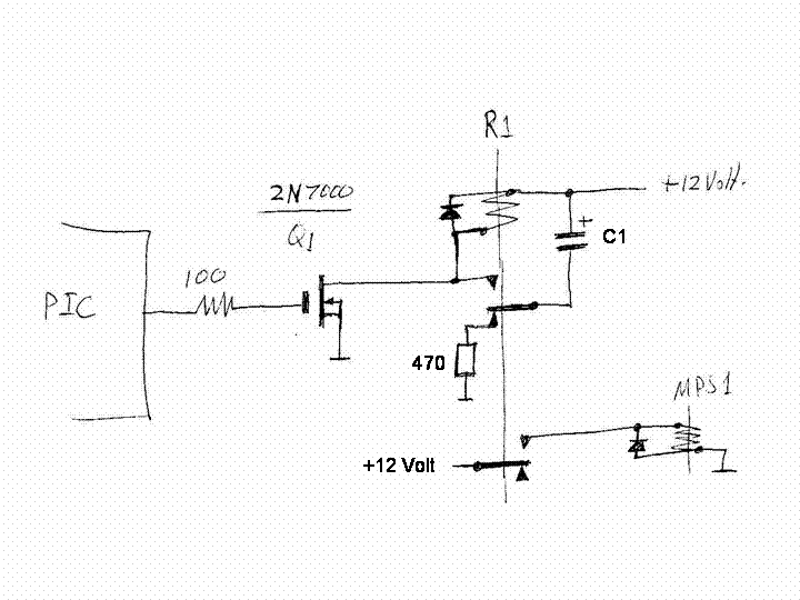

Here is another option for you to consider.
C1 is charged via the resistor when the power is turned on.
The PIC applies a pulse to turn Q1 on long enough to operate R1.
The capacitor charge holds R1 operated briefly after the PIC pulse is removed.
C1 re-charges when R1 releases.
If you want to proceed with this option, I can calculate the value of C1 if you tell me the coil resistance and release current of which ever relay you choose.

Good design and I can sort of follow what you mean, I think the cost of the relay may make this as a dis-advantage. The first design you come up with works and the cost isn't that bad.

Yes, I thought the size and cost of the relays might be an issue, but I like to give people options so they can weigh them up and choose.
One advantage of the relay option is that the PIC only has to generate a pulse long enough to reliably operate the relays which is normally <30 ms.
So you would not have any overlap issues, ie. the PIC could queue the MPS operate requests (ie. if 2 or more happened by chance to occur within 30 ms)and operate the relays in turn.

Use 220 nF and a 6M8 resistor. These give about the same time constant.
Besides, if you look at the calculations I posted, you will see that the Schmitt Trigger ICs have a wide spread of threshold voltage so you will have to choose R and/or C in order to set the delay at about 1.5s. If you don't understand this point, let me know and I'll explain in more detail. It is a statistical issue.

Yes I am. The only problem is I have to build a cct for this, so I'm planning to build one PCB with the Schmitt Trigger with a time delay of around 1 second, then I will improve on this with the following 49 PCB's. This way I can make sure the Schmitt Trigger idea works and then test the closure time of the MPS.
I've looked at the spreed-sheet and understand the Min and Max value's (and your right, there is a lot spread. I'm gonna attempt to get approx 1 second time-delay with the first PCB and then attempt to improve from there.
You are confusing the max gate voltage with the gate voltage necessary to turn the FET on. If you study the data sheet, you will see a graph showing that for a Vgs of 2.5 Volt, the Id is about 40 Amp (from memory).
So if you drive the gate from the output of the inverter, (ie. 5 Volt) it will be more than adequate for your application.
So If I put the Source to ground, the drain to the low side of the MPS and then drive the gate directly from the invertor, this should work????? I've attempted this before and got into all sorts trouble. I'll Try again.
Jason
Jason
Yes, but don't neglect putting a diode across the MPS coil to protect the MOSFET.
