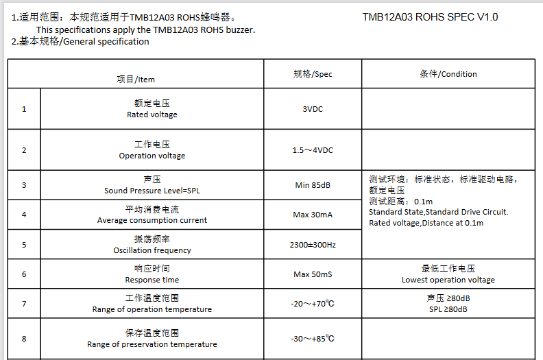

I made the change. the result was no difference in how loud it was but there was also a constant faint whine now. unlike the ones i posted before these 5V transducers have a part number. Here are the specs.
I had thought that these were 12V. The reason i did not use them. The ones i was using had no part number. I relied on the outlets datasheet for info. To be honest the ones i was using i have no way to determine what the real ratings are.
Screenshot 2021-11-12 at 16-20-41 1811141123_Jiangsu-Huaneng-Elec-TMB12A03_C96222 pdf.png
These are not 5V transducers, they are 3V (operating voltage) transducers. The acceptable range is 1.5-4vdc. The resonant frequency will change +/- 300hz and I'm assuming that is associated by a change of operating voltage. Usually, there would be a graph showing the operating voltage vs resonant frequency. So...if the operating voltage changes, the resonant frequency changes, so the 555 driver frequency needs to change or there will be a change in buzzer loudness.

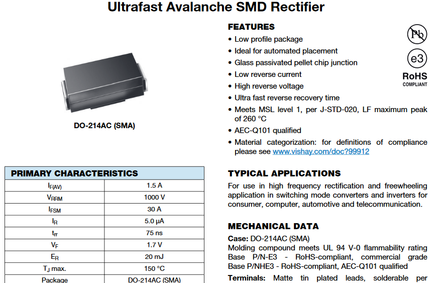

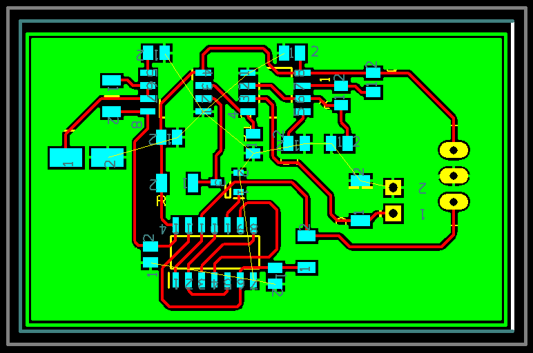

I would like to make this project with all SMD components. Ive located everything except the diode. You have any suggestions or recommendations on this route?
I get parts from Mouser, but 1N4148 is pretty common, you can get it from just about ant parts house.
Have you designed an SMD PCB before? Traces will be harder to route since via's aren't used. You can add via's but then the board cost goes up.
If you are going to assembly the board yourself, you may what to limit the size of SMD devices to something that is easy to handle when hand soldering. You won't be able to use a socket with the SMD 555's, and you could replace the two 555's with a single NE556 dual timer chip.
There are PCB fab houses that will assemble the board as well, but usually the parts have to be from their inventory. JLPCB is one such fab house.

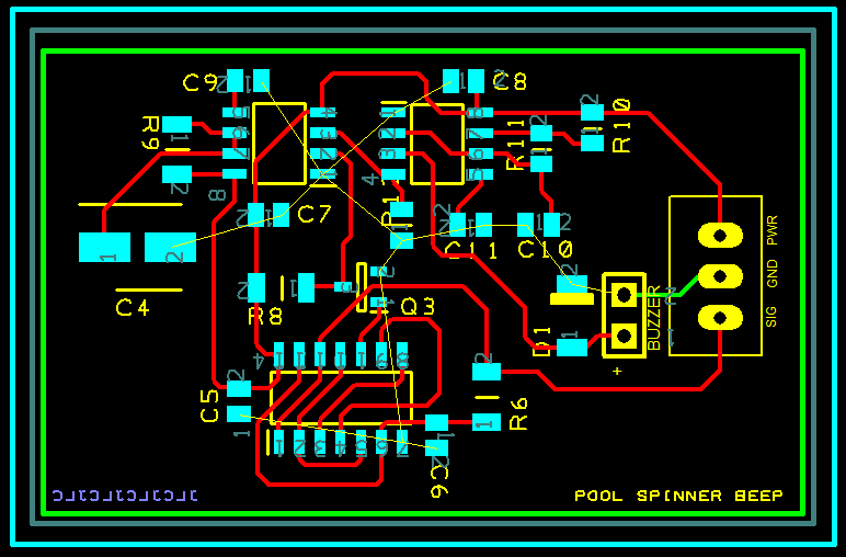

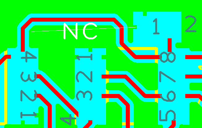

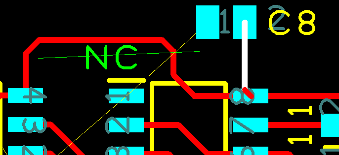

Gap in net?
Its a glitch. I have no gaps but after i pour the copper to connect the ground net to the smd ic's then run the rule checker i get these two errors. Gap in net. It is a GND track. They are connected to a pad on component but then go nowhere. I can delete the error then there is nothing there. nothing to connect, nothing to correct. nothing to join. What should i do? if anything. in Gap02png i move the component and the Error remains where it is.

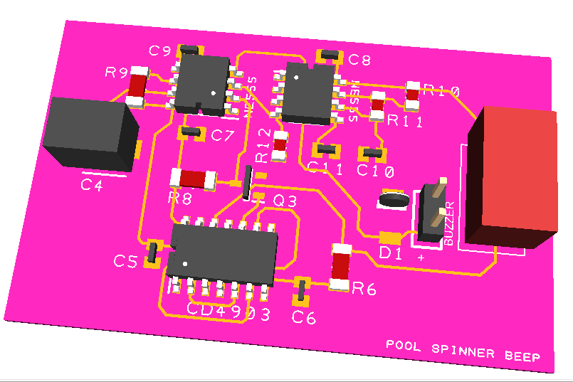

3D render.
Speaking of diodes. I could not locate a ECAD model for design spark. I made the one here. I can see it needs some work.

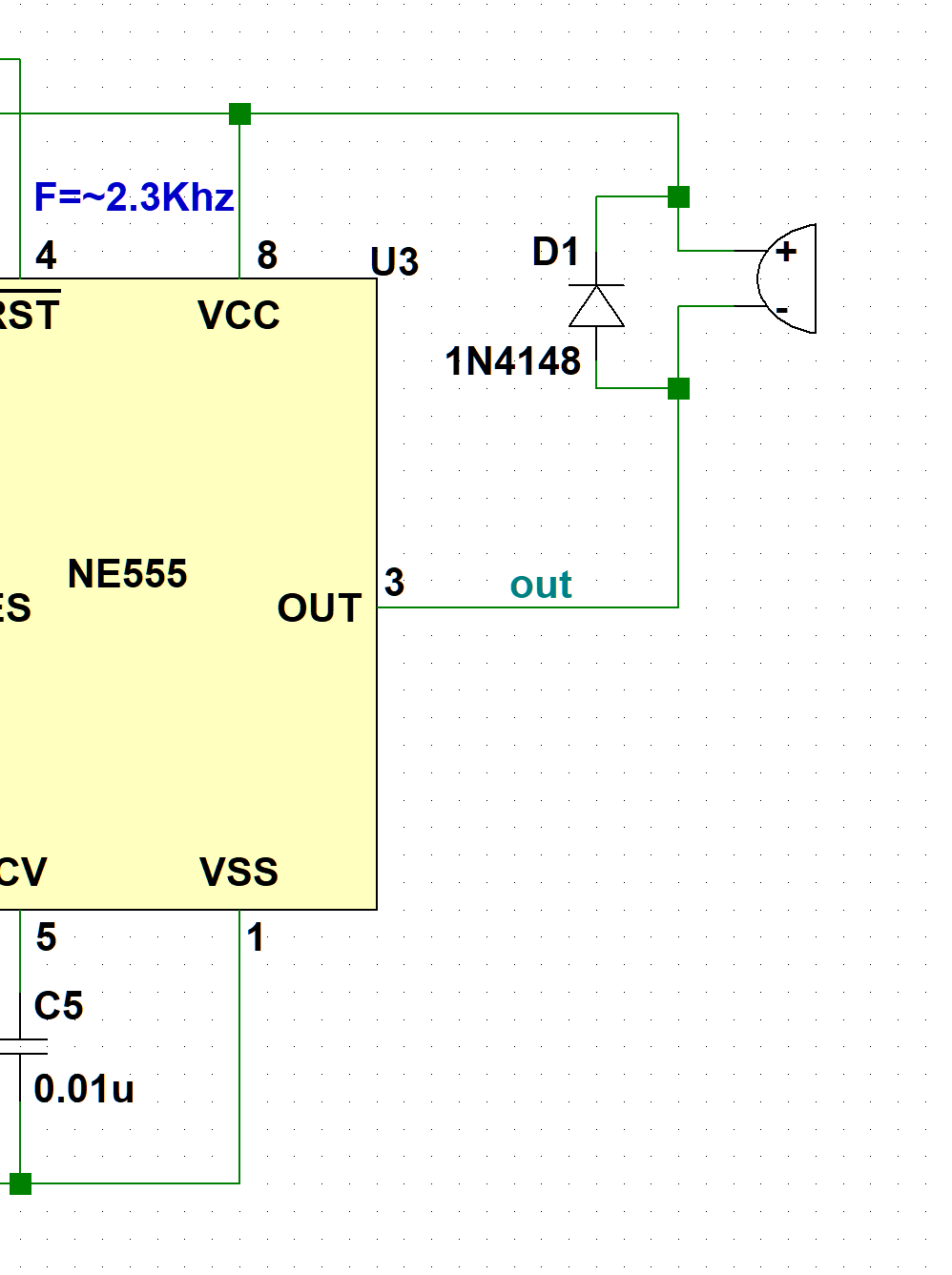

Hi

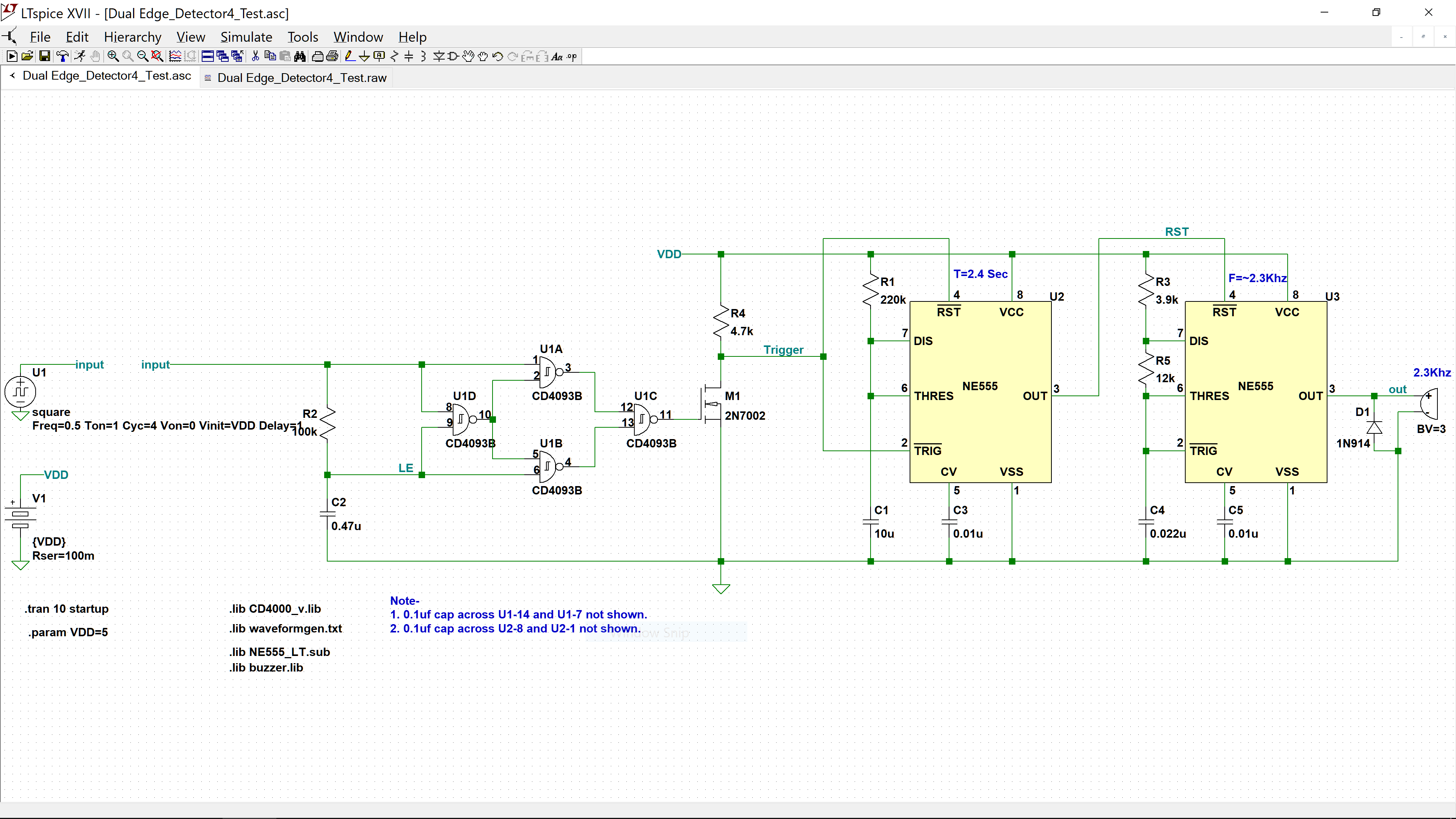

I made a small but important modification to the circuit. See below.
The previous circuit would not reset for each pulse at the trigger of U2 resulting in missed state changes.
So to fix this, I've connected U2-RST to U2-Trigger. I also removed R6 (don't really need it since the output is already internally pulled down to ground), then reused it to replace R4. With this configuration, U2 will always reset when a trigger is detected. The resulting modified circuit is below.
