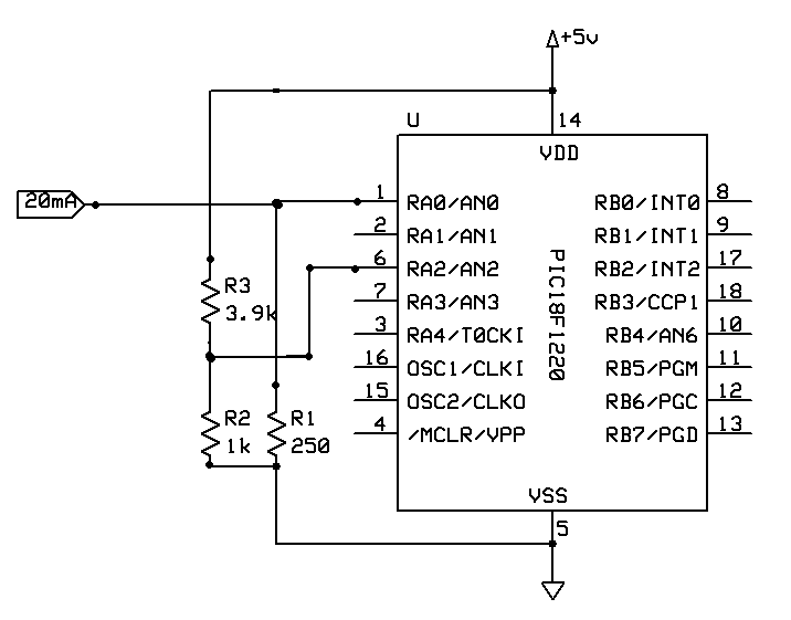

The Idea of the shunt resistor is a current to voltage converter , @ 4mA there will be 1 volt Gnd - RA0 and @ 20mA there will be 5 volts gnd - RA0.
A 4 - 20mA sensor will only provide this current
Ian Rogers I know how it works But I don't see this working I read from gnd to top of a stunt that gives you a mV reading 20 mV which is 20mA.
I just got done making with one that can read Amps and give you watts using a .5 ohm stunt and a opamp. to scale to 0 to 5 volts
This what I see happening You put 20mA on RA0 the resistor will clamp that to 0
Well I figured I didn't have any thing better to This works find if you set the hardware right. Nice 20 ma reading and the 4 mA is a little off

hi burt,
That circuit has been on the table for the past few posts. ref post #17
Like the rest of us, I am waiting to hear from 'aljamri' what is the problem really is.??
If he has followed the advice in the posts, he should have +1V on -Vref , +5V on +Vref.
A 250R resistor from ADC0 to 0V, with the 4mA thru 20mA from the signal current loop, this will give +1V thru +5V at the input of the ADC0 pin.
The PIC program has ADCON0 set up correctly, for the Vrefs etc..... so it should work.
So, 1V at the ADC0 pin gives 0 adc counts, for 5V at the pin gives 1023 adc counts.
Its method is not rocket science, its in common usage.
So aljamri what is the problem you are seeing.???:)

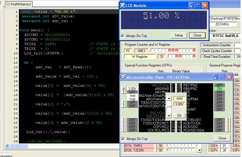

As long as my circuit refuses to operate, I turned my attention for the software trying to achive the zero shift and I think I've made some progress, here is the code and the OshonSoft shot is attached:
 char *value = "00.00 %";
 unsigned int ADC_Value;
 unsigned int adc_val ;
void main() {
  ADCON0 = 0b11000000;
  ADCON1 = 0b10001111;
  TRISA  = 0xFF;              // PORTA is input
  TRISB  = 0;                 // PORTB is output
  Lcd_Init(&PORTB);           // Initialize LCD
  do {
       adc_val   = ADC_Read(0);
       adc_value = adc_val - 204 ;          // To shift the 0 1V
       value[0] =  adc_value/82 + 48;      // (1024 - 204)/10 = 82
       value[1] =  (adc_value/8)%10 + 48;  // (1024 - 204)/100 = 8.2
       value[2] = '.';
       value[3] = (adc_value/1)%10 + 48;    // (1024 - 204)/1000 = 0.82
       value[4] = adc_value%10 + 48;
   Lcd_Out(1,5,value);
   Delay_ms(2000);
  } while(1);
EDIT: I have to tell you that Nigle in post#13 here, and Eric in another thread, told me to do software-zero-shift. Thanks for both.
