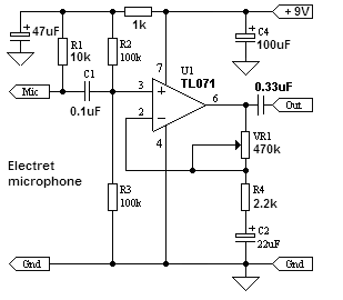

You forgot to say which type of microphone you have. My preamp circuit will be a little different if you have a dynamic (coil and magnet) microphone.
I have the schematic of a preamp for an electret microphone using a TL071 single opamp.
It gain is adjustable with the 470k trimmer resistor that can be an ordinary resistor for fixed gain.
Its supply voltage can be from 7V to 36V.
What parameters do you need?
The frequency response is to 100kHz and its distortion and noise are very low.

Ok thanks , audioguru, for your reply. But pls can,t i get one from the tl074cn.? The mic. Is the motorola gm300 radios , 2way radios. Regards savy
Look at the datasheet of the TL071, TL072 and TL074 to see the pins numbers.
I don't have the radio that you have so I don't know which type it is its microphone. It is probably electret.
