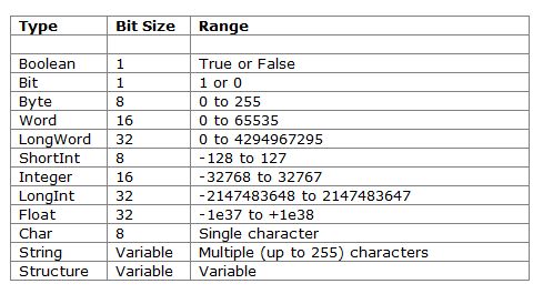

setting up ADC port
It could be an INTEGER, but unless you are expecting negative values from the ADC, a WORD would be better.

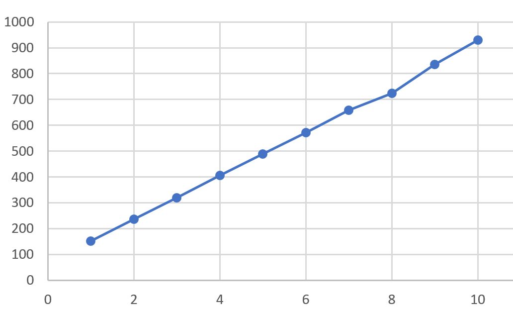

here it is close but not liner when it gets to one end of resistor ladder

the test points (where switches connect) go 454, 409, 322, 279, 238, 197, 156, 115, 745
as predicted it follows the voltage but my math is wrong. the 745 is supposed to be less than 115. should be .745??
Guess what the statement:
ADVal = ADInAsVolt
does?
It takes the 10 bit ADC value and turns it into volts. You lose resolution and then get lost in dealing with non-integer numbers. [echo, echo, echo....]
Replace that line with:
ADVal = ADC.read(0)
Change this:
LCD.Write("DC Volts = ", DecToStr(ADVal))//, ".", DecToStr(ADVal, 2), " ")
to this:
LCD.Write("ADC = ", DecToStr(ADVal)), " ")
after some editing suggestions it now works as desired

output = 152, 236, 320, 405, 488, 572, 659, 723, 836, 929now omn to building the CASE SELECT  portion
