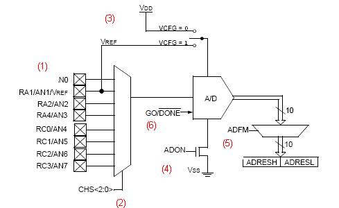

This is a discussion for setting up the ADC module in PIC16F684. For detail operation of ADC please refer to Microchip data.
There are five registers involved in ADC operation: ANSEL, ADCON0, ADCON1, ADRESH, ADRESL. We only need to set up ANSEL, ADCON0 and ADCON1. The conversion result will be stored in ADSEH and ADSEL.
Please refer to block diagram (from Microchip data):
We will set up the registers in the order of the red numbers in the diagram.

(1)  Select analogue input. In our example, we chosed pin 11 of the chip,
      which is AN2.
                               ANSEL=  0b00000100;
(2) Set CHS bits in ADCON0 to select the channel to connect to sample and
     hold circuit.
                               ADCON0 <4:2>  =    _ _ _  0 1 0 _ _
(3) Set voltage reference source in ADCON0<6>.  0= VDD, 1= Vref pin. We
     choose VDD as reference. So,
                                ADCON0 <6> =    _ 0 _ _ _ _ _ _
(4) Initiate ADC module by setting "1" in  ADCON0 <0>  ( doesn't mean A/D
     conversion starts).
     Set DO/DONE bit in ADCON0<1> to off, not starting conversion yet.
     ADCON0<1>= 0.   So,
                                ADCON0<1:0> =  _ _ _ _ _ _ 0 1
(5) Set A/D conversion format, left or right justified, in ADCON0<7>. The
     result of the conversion is in 10 bits and will be stored in  ADRESH and
    ADRESL register.  Left justified is :  xxxxxxxx   xx000000
                                          ADRESH      ADRESL
                            Right justified is: 000000xx   xxxxxxxx
                                                 ADRESH      ADRESL
    We choose left justified, so
                                ADCON0 <7> =  0 _ _ _ _ _ _ _
    To sum up for ADCON0:
                                ADCON0= 0b00001001;
The setting with reference to the block diagram is complete.
When we want to start the conversion, we simply set GO/DONE bit to 1, ie
(6)                             GODONE= 1;
 Next we have to set the conversion clock:
(7) Set the A/D conversion clock  (TAD)  in ADCON1 <6:4>.
     We have to ensure a mimimum of 1.6 uS TAD for proper A/D  operation.
     For 4 MHz device frequency, we should select 8 Tosc (2.0 uS, which is >
     minimum  requirement).  ADCON1 <6:4> =  001.
                                 ADCON1= 00010000;
     If we don't want to calulate this value, we can just set ADCON1 <6:4> to
     x11. The TAD is 4 uS with this setting.
To sum it all up, we only need three C statments to set up the ADC.
Analogue input= AN2
Voltage reference source= VDD
Device OSC= 4MHz
C statments:
                     ANSEL=  0b00000100;
                     ADCON0= 0b00001001;
                     ADCON1= 00010000;
Note, the ADC setting for this chip is different to 16F87x.
Next we will use this setting and connect a POT to AN2 to control 8 LEDs......

...Now I assume all that's left is to set the ADCON0 bit 1 to start a conversion and then to read the result from ADRESH and ADRESL. The PIC16F684 will automatically clear the ADCON0 bit 1 upon completion of the conversion, as I understand it.
Can it really be this easy? I guess there's only one way to find out!

You can get a bigger version by typing [img]https://www.electro-tech-online.com/attachments/adc_b-jpg.17423/[/img].
Like so,
You might also want to add a mention of the acquisition time.
