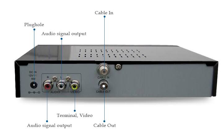

Set Top Box Cable Out connection.
Attached image of Cable Set-Top Box.
The Cable In connection is the Cable wire provided by the Cable operator plugged in.
What is the significance of CABLE OUT connector?

Why don't you just read the manual for the set top box?
That is where you will find the authoritative answer.
The top connector looks like a "F" style and the bottom a European TV connector.
In any event, the most likely use is to provide pass-thru when the STB is off.
A manual would provide a definative answer.
If it was the US and it was a ATSC DTV converter box, the above would be true and the box would provide NTSC channel 3 or 4 output selectable with a physical switch.
The manual would be the source of information that you seek.
That was my thought - an analogue RF output - although it could well be UHF, and quite probably fully variable from a menu on the box - it all depends really where you are?, and if VHF is in use or not?.
However, it looks a pretty minimal low spec box, with just the two lowest quality outputs possible (composite and RF).
