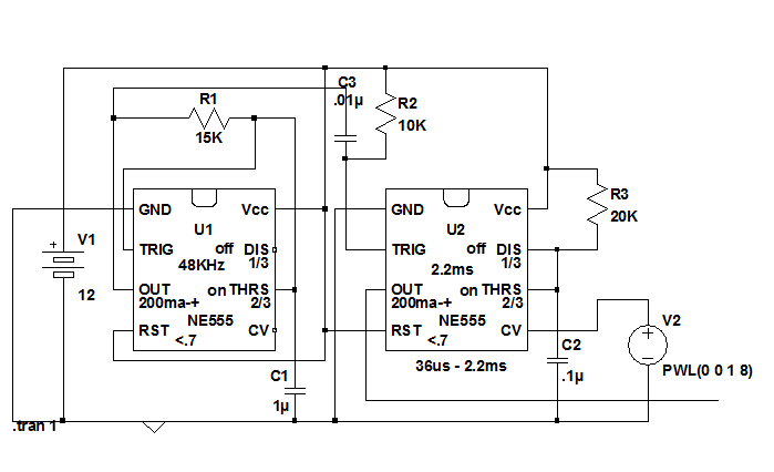

Here's what I have for controlling a servo, it's 2 555s, first one has a ≈ 50Hz signal and the second one is a ≈1 - 2ms single shot triggered by the first, I am controlling the 2nd via the CV, pin five because it works for my application. I suppose a pot for R3 would work for you. If you run the sim, look at the voltage on CV and the width of the pulse.
I'm using this on a cruise control for an off road vehicle, if you want the complete design. just ask
As far as speed of the servo goes, IMHO, if you change the signal from 1ms to 2ms, the servo will get there as fast as it can. If you want it to take a minute to move that far, make your signal change take a minute. That could be done using the CV, pin 5, with a ramped voltage to control the time pulse.
