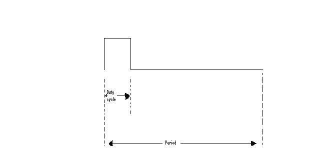

I connect the wires again and Ya its working now. But its shaking (jittering) in the desire place. I am not sure what wrong.
When I used function generator to operator it. It operates, but the problem is I am confused which parameter I am suppose to change duty cycle or period? Look at the diagram to understand more.
When I kept the duty cycle at 50% it operates from 0 to 120 by changing the period from 1.6ms till 4.3ms.
But when i kept the duty cycle at 20% it change from 0 to 120degree by changing the period from 4.1ms till 10.9ms.
I am confused which paramerter to change duty cycle or period. Both work, but which one is better?
When the frequency is 500Hz i can change duty cycle from 21%-62% to have that interval.
Q2> I am using pulse in function generator and its working fine when I use square wave it going crazy or jittering. You know how I can produce pulse using PIC? Any ideas?
Thanks in advance

Stop fussing with the function generator and guessing at values. Servos have specific parameters if you want them to function.
Here's my advice
Write code for whatever PIC you plan on using in assembler that will output a 1.5ms pulse every 20ms to port RA0 and run it using the MPLAB simulator. Stop playing with stupid values you think might work and start following specifications. You are proceeding at a snails pace because you simply don't seem to follow advice.
I agree with Bill about the stop fussing aspect and have a little experience with running model servos at more than 50 Hz.
At frequencies a lot higher than 50 Hz, you have no idea what the servo is "seeing." For example, 500 Hz is 2 ms per cycle, which is what the servo expects to see as its control pulse, not frame rate.
As for the shaking, when I ran a different brand servo (Hitec) above 150 Hz or so, I still had control of movement, but lots of buzzing and shaking.
