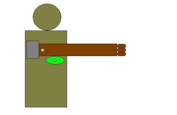

I have an Xmas decoration I made out of plywood. Two, actually - Homer and Barney from the Simpsons in Santa suits and drinking Duff beer.
Anyway, Barney's arm is sticking out holding a mug of Duff. It needs to go up and down like he is drinking it, pivoting at the shoulder. The arm is roughly 10" wide and about 3.5' long made out of 3/8" plywood, so it is heavy (I have not put it on the scale to weigh).
I would like the arm to cycle smoothly once every 5 seconds (up and back down at 0.2Hz). So I need to rig up some sort of motor to do this, and I assume it will need to be beefy. I am very experience with PIC's and PIC programming but I know nothing about electric motors or servos.
Please help! Barney's arm needs to be helping him gulp beer by next Xmas.
Like 3v0, I think a gearmotor would be the better solution. From what I've seen, you can buy new/surplus-new ones that would be ample for what you need for somewhere in the $5-$10 range. For instance:
https://www.robotobjects.com/scripts/prodList.asp?idCategory=30
The same website has worm gear sets that you might consider using. Counter-balancing the arm is a very good idea - maybe you have some old bits of metal (something compact and heavy) to fit in the shoulder?
My preference is for a continuous rotation motor, as oppose to one that's constantly changing direction. Maybe you could connect a dual-lobe cam (elongated oval shape) to the output of the motor. With the counter-balance set so that the arm part always puts just a little bit of weight on the lobe, you could get away with using the least amount of power for the effect.
Also, having the counter-balance, and the cam separate from where the counter-balance/arm is attached to the figure, you don't need to worry too much about stress on the output shaft of the motor (because you'll have the other point where the arm pivots that can be quite beefy, without the bother of figuring out how you'll connect that part to a motor).
You could make the cam out of a 1/2" to 1" thick piece of UHMW, and have it contact a thin strip of aluminum on the underside of the arm. That way, the arm will move quietly and be self-lubricating. The cam doesn't need to be big - just plan where it's positioned with the arm, and the arm balance carefully. The cam should glue easily to the motor shaft. You can get UHMW at most places that also sell sheet metal (call first!).

There are many more ways to go. Linear actuators, pneumatic cylinder, water pumps etc.
If the arm is balanced use a inexpensive fountain pump and PIC for a timer. Pump fluid into a reservoir at the hand to lower it. When the pump shuts off the arm will come back up as fluid drains out. The reservoir drain hole is open all the time. The pump is twice as fast as the loss through the drain. Pump is on and off for equal times.
People have used auto style air shocks as actuators for greenhouse vents. They are too large for what you are doing but you can get smaller surplus cylinders.
If you are OK with reversing the motor the site Hank mentions has rack and pinion gearsets.
Use a Window motor as already suggested.
