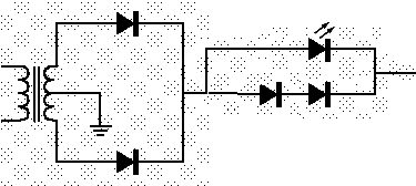

Who knows where these old 120VAC-to-6.8VDC wall warts came from, but I suspect they powered mobile radio chargers. I took one apart to find out why the LED didn't light up, and I uncovered a mystery.
Measured: pri 120VAC; sec 20.8V=2x10.4V; rectified to 8.9VDC; output 8.0V; LED tested good
The full-wave rectifier is standard, but what on earth are those other diodes doing? Of course the red LED won't light up--with its 2V drop it will always lose out to the series diodes at 1.4V. Nobody includes a component that will never function, and what power supply has no regulation or filtering? Clearly there had to have been another device down the path to complete this circuit design, containing caps, coils, resistors, etc., and of course a path to ground/earth through resistance. Note also that the 8V unloaded output is well beyond the 6.8V spec marked on the case.
What additional component configuration may have been located beyond this circuit's output? Regulation and filtering no doubt, but I can't imagine what could have induced that LED to light up. Any ideas?

Small cheap red LEDs clock in with a Vf in the 1.6 V to 1.9 V range. And rectifier diodes, even small ones, have a Vf above 0,7 V at any appreciable current, and this Vf increases with increasing current. Thus, the LED comes on when the current is high enough. shunting most of the current around the LED.
It is very common for unregulated wall warts to have a wide voltage range between unloaded and full load. This is due to a combination of low cost transformer steel and amplitude of the peak-to-peak ripple voltage. What is the load current on the device label?

Agreed; it's a "Charging" indicator, on when the load current is high enough and off when the device was fully charged, or near so.
With no filter capacitor in the power supply, the output current will have very large ripple. In fact, there will be spikes of current near the voltage peaks, and zero current the rest of the time.
With a large peak current, the peak voltage drop on the diodes will be larger than it would if the current were steady, so that will also help get the voltage high enough for the LED to light.

So thank you AnalogKid for identifying the voltage drop variability. If I understand correctly you're saying that once there's actually some current flowing in the circuit then the voltages could be right for the LED to light...and thus when the battery attained full charge then the current flow might cut back and the LED would go off, indicating that the charging was complete.

Right Diver300. When writing my original post the lightbulbs were slow to go off in my head. Looking at the schematic I had drawn from a visual inspection of the internals I noticed there was no filtration...then I saw there was no regulation...then no current-limiting resistor to protect the LED...and only then did I notice there wasn't even a path to ground. I guess it takes a lot of practice to see the obvious right off the bat.
