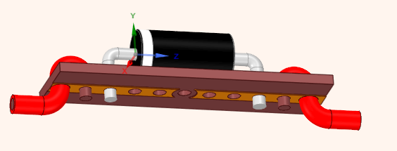

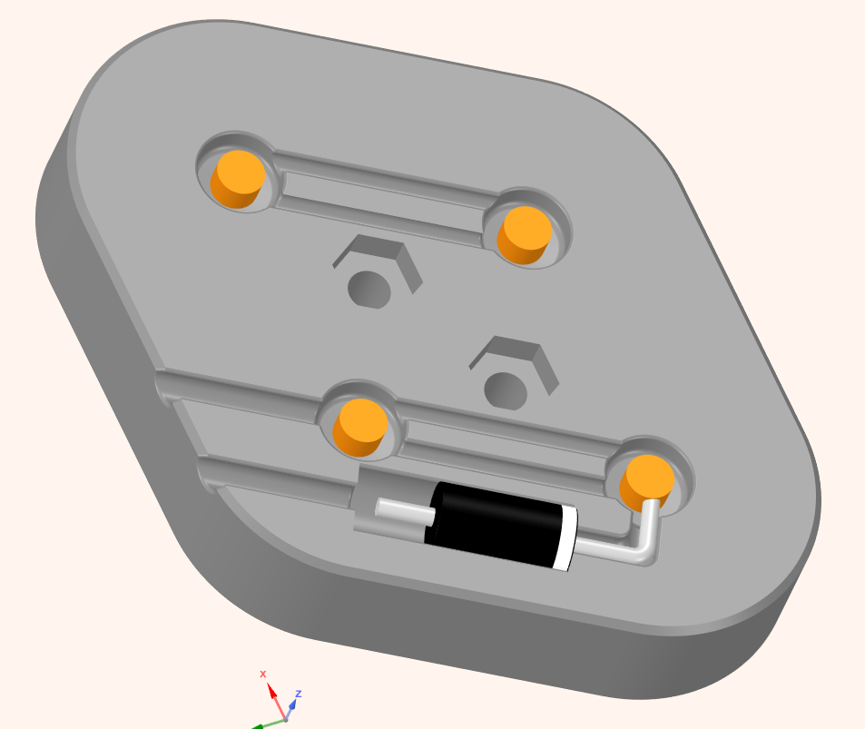

That would mean modifying -- physically -- the existing circuit board; or incorporating the diodes into the flying leads. The former would be difficult, the latter a bit iffy. Even if I mount it on a bit of veroboard and shrink wrap it; it smacks of things to come loose in the future.
Seems it would be physically easier to set it into the pack caps:
If that makes electronic sense?

And I've decided that 4S is probably too much for the 12V motor -- it works, but it gets very warm -- so I'm printing some caps to make pair of 3S packs.
In turn that frees up enough space to allow me to mount one (or both in parallel) of the TO-220s attached to a small heatsink in a convenient position.
