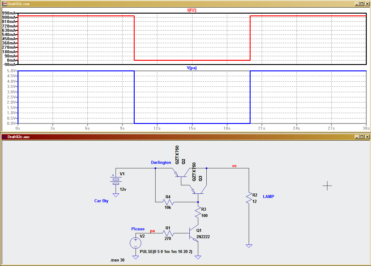

Problem with the Darlington being driven by a 5V signal source is that its not possible to get at the emitter more than [5V - Vbe] drop, about 5V -1.4V = 3.6 across the LED's.
Ref: my edit in post #4
EDIT:

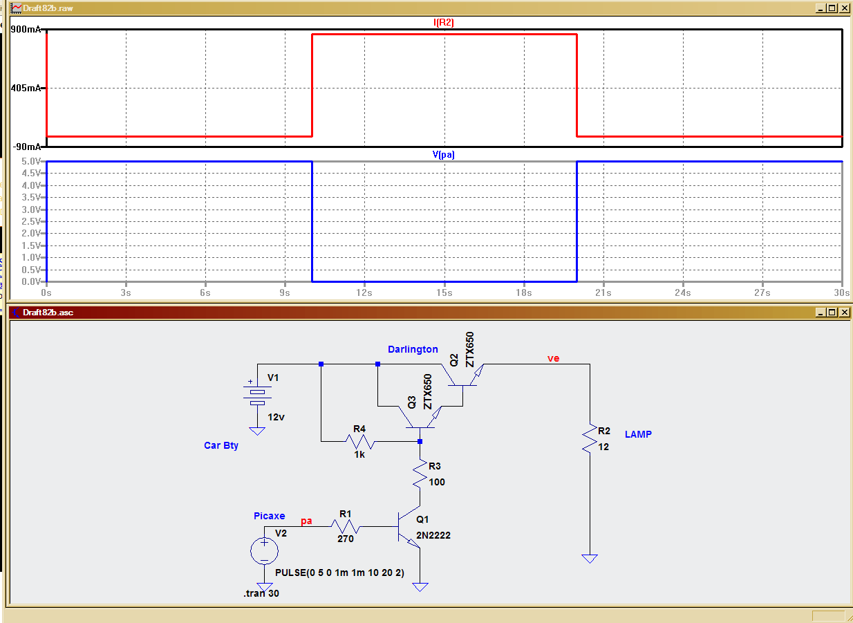

This is a darlington option using a NPN type, note the led's are ON when the picaxe output is low.
This will give ~ 10.5V across the leds.
Yes i should have known that.
In your schematic could i just use a low output to drive Q3 from the picaxe and not use Q1.
Or is Q2 really needed and not have a darlington output.

hi Pete,
Driving Q3 direct from the picaxe, would put 12V on the pixaxe pin, when the pin goes high.....
Catch you tomorrow...

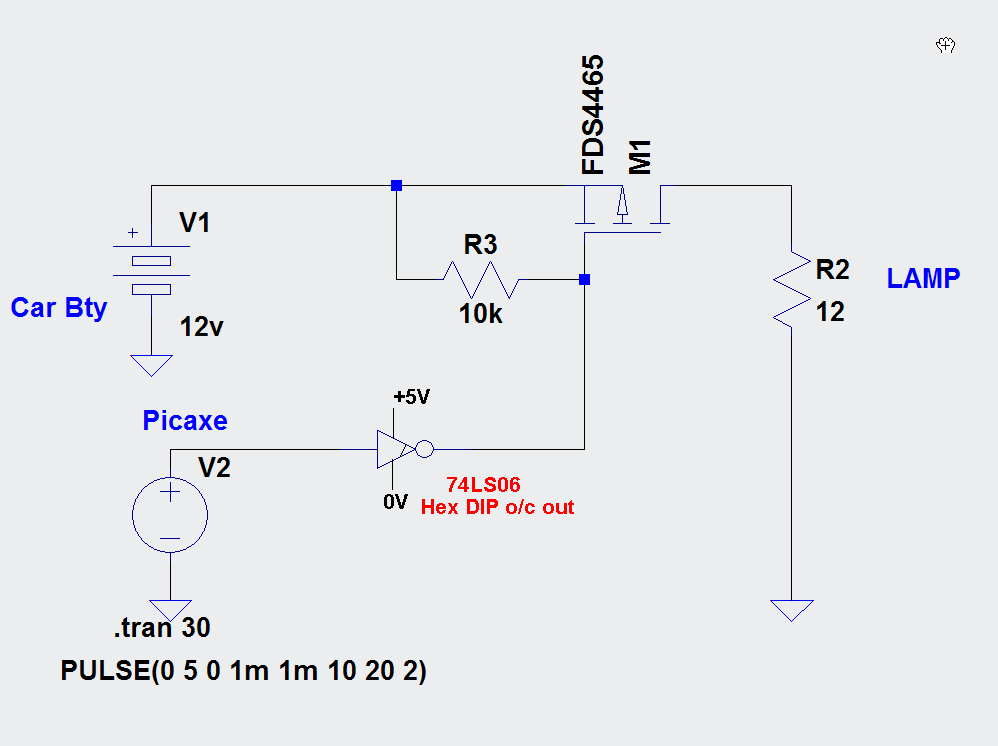

Hi Pete,
This option sets the leds on when the picaxe pin is high
EDIT:
If the OP can get a 74LS06 IC, this will reduce the component count.
Ref image #2

Thanks old mate,
I do rather the fet circuit now and this all needs to fit on a tiny board apparently, so a lesser component count the better.
