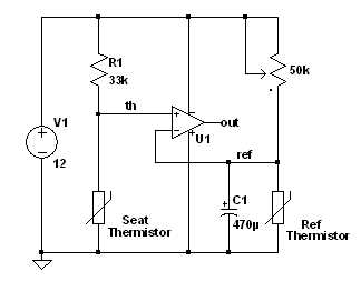

Here's a simple circuit using two thermistors; one as the seat sensor and the other as a reference allowed to reach ambient temperature close to the seat squab. Simulation shows that the R1/thermistor junction voltage changes by ~60mV for a 1°C temperature difference between the two thermistors.

Yes sir your right.
As a solution to this problem we can use differential amplifier circuit as shown above.
One thermistor tells the surrounding temperature output and other can be used to measure temperature due to presence of human.
Yes sir your right.

The problem would be that the cars interior could be at a higher temperature than the heat transferred thru the humans clothing and car seat to the thermistor.
Your original idea of a mechanical sensor sounds the best solution.
