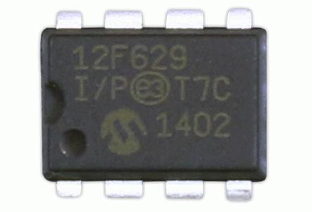

The timer module uses a PIC 12F629 as the timing engine. As such, a brief relay pulse is a surprise and a sign of bad design.
