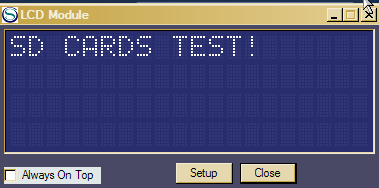

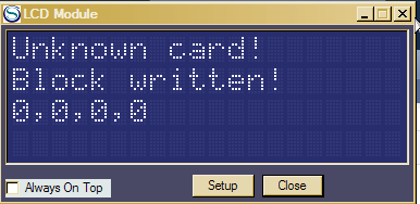

Do you get either of theses images of the LCD.?

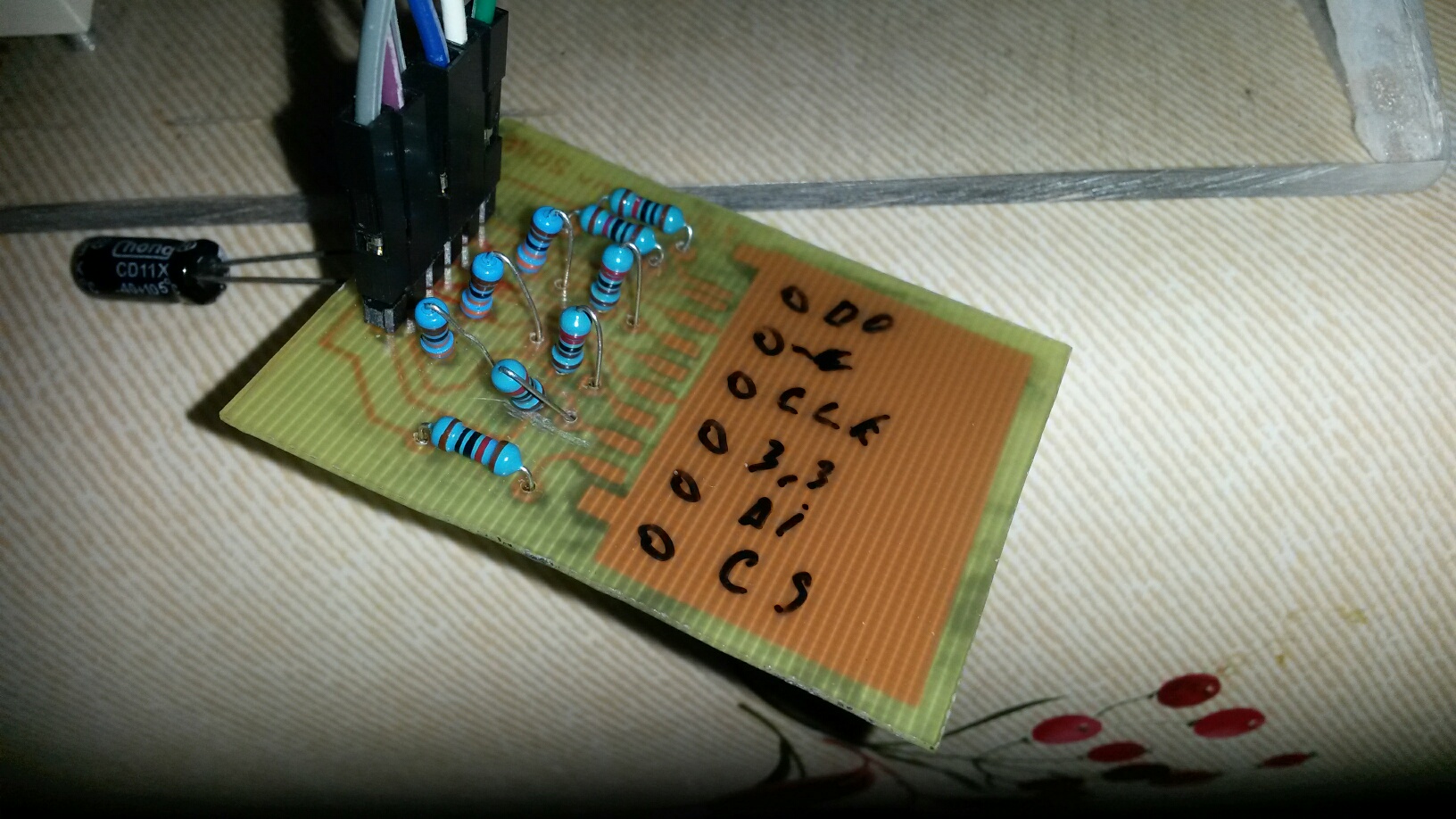

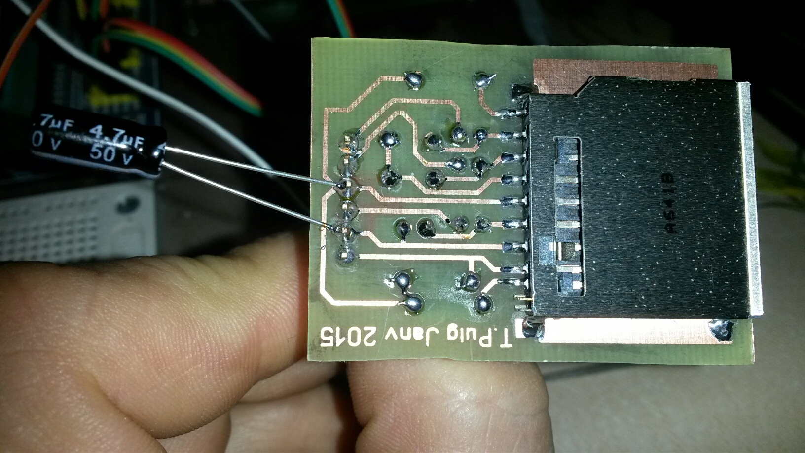

I use the 3.3 v to the SD card and 5 v for 16f876 with divider bridges SDO SDI, I just put a 4.7 uf, and I tested with several 256meg SD card
1 g and 8g, some pictures.20150110_163408_resized.jpg 20150110_163424_resized.jpg 20150110_163435_resized_1.jpg

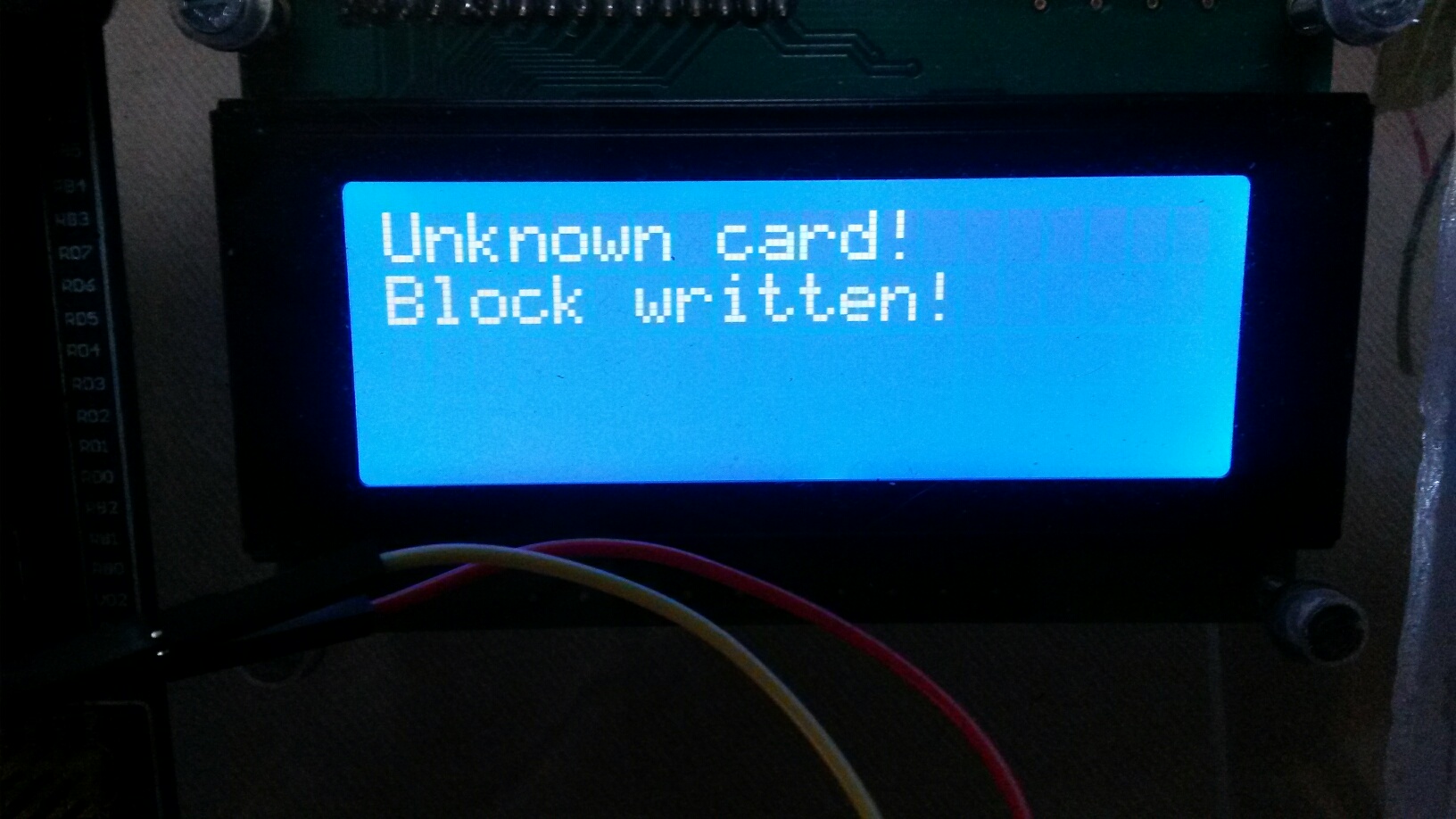

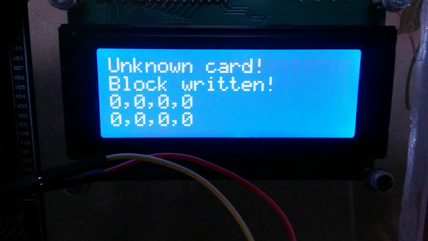

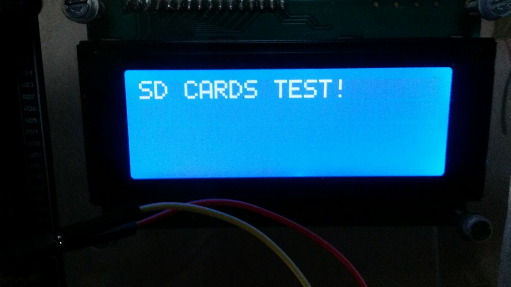

here is my LCD
20150110_165532_resized.jpg 20150110_165535_resized.jpg 20150110_165538_resized.jpg
but it does not have the expected result !! the display should send me the type of card (SDHC, SD ..) and the reading writing test is 0 ..

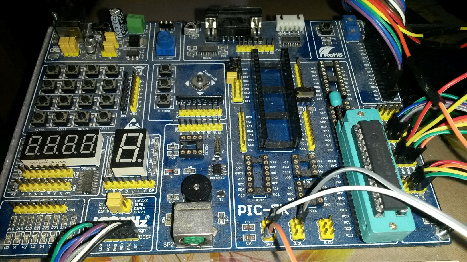

hello
I have a special license pack1 functions.
with 18F4550 the result is the same,
the 18F4550 SPI protocol SDO = RC7, SDI = RB0, RB1 = CLK, CS = RA5
but may use other pin?
I just did the test with external 3.3V supply, failure ...
Thierry
Hello
I found ...... you just reverse SDO and SDI
RB0 = SDO, SDI = RC7, CLK = RB1, CS = RA5
thank you
Thierry
